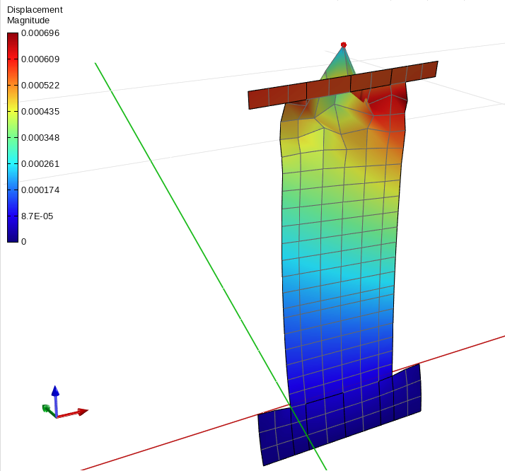

something really weird happens to your model, look:
I don't think you wanted to create that kind of boundary condition. I didn't get the use of the equalDOF you wanted to make. Usually, we create interactions where we want to assign specific internal boundary conditions between disjoint geometries, but you only have one geometry. If you want to make the top shell portion very rigid you can just assign an elastic rigid material. Try to review this and rerun your model.

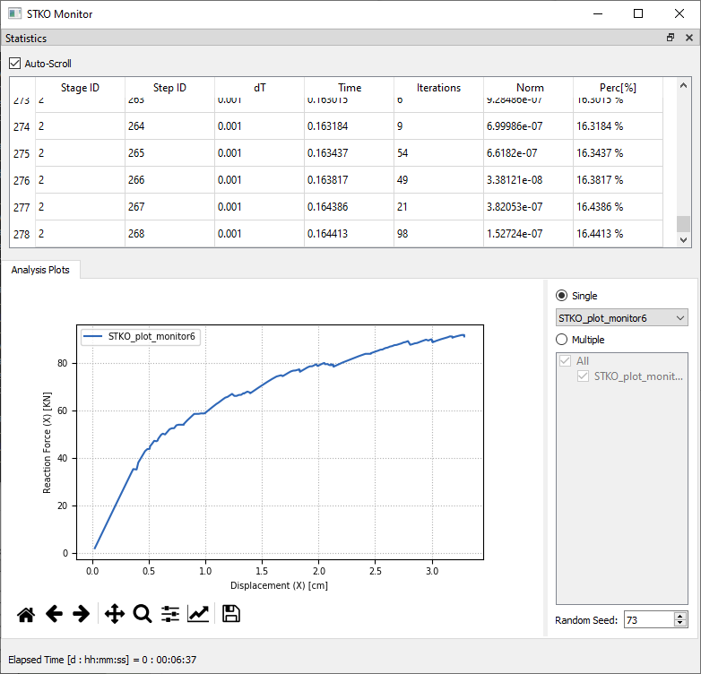

Re: LayeredShell for shear walls
Post by STKO Team » Thu Sep 30, 2021 1:04 pm
Here is a working version of your model.
To calibrate the post peak regime, you have to play with the fracture energies (Gt and Gc).
pdf_t and pdf_c are used to calibrate the amount of plasticity (0 = pure damage, 1 = pure plasticity). A good value can be 0.5 for both.
I also changed your analysis to make it more stable: instead of an applied force + a displacement-control, I applied an imposed displacement with a load control (it converges better, and it is equivalent in this case were you have only 1 horizontal force).
Finally, I would raccomend you to check the parameters of your steel material. The isotropic hardening ratio seems to high, and it looks like steel is not yielding enough
Test22.zip
(172.87 KiB) Downloaded 217 times
