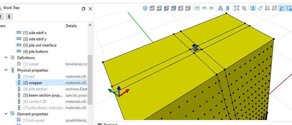

I have analysed a soil-pile system where I want to read the material stresses and strain of the soil elements. In Opensees if we set the recorders (for eg. "recorder Element -file Gstress1.out -time -eleRange 1 $nElemT material 1 stress") we can extract the data very easily and then for a particular element we can read the stresses and strain. But I am finding it difficult to extract the results in STKO postprocessor. No doubt we can view the contours of stresses and strains for the whole geometry, but getting the data in each and every element is difficult.
I have even tried to manually extract the data through the "custom command" option, but in the .out file nothing was there except the time column.
Also, if I want the displacement (or bending moment) at each node (or element) of the pile, it is very difficult to extract it because the pile is hiding inside the soil. Selecting each node becomes very difficult and tedious.
I hope there are some other alternatives to this. Please shed some light in to it. Thank you.

If you want to select something that is hiding, you can hide the surrounding geometries with the Hide/Show command.
I wrote it wrong. Definitely the soil can be hidden by the show/hide command but my pile is modelled with a beam-column element and it is a hollow circular section. So, I can't click the inside nodes (I hope you can understand what I meant to say, it will be clear once you run my file). I don't know if there is some other way to do it.

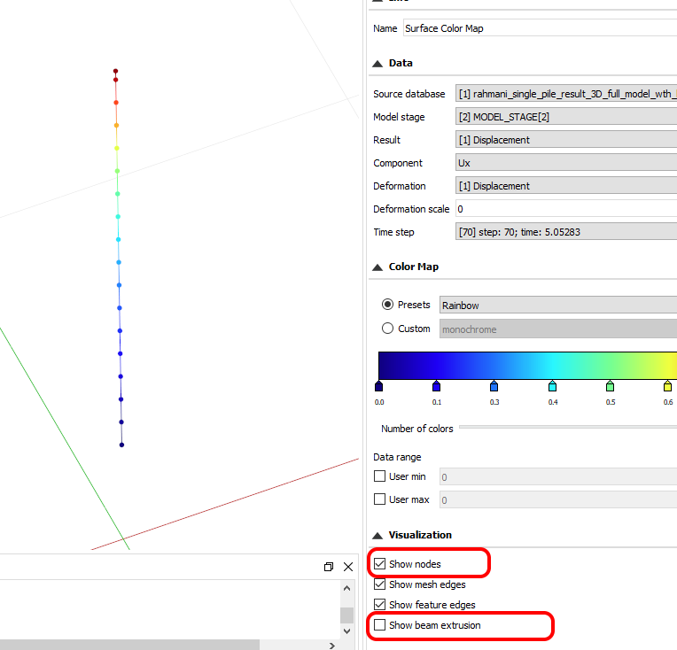

You need to isolate the beam elements with the hide/show command. Then, to hide the beam-section extrusion, just un-check that option. You can also check the option to visualize the nodes, so it will be easier for selection
