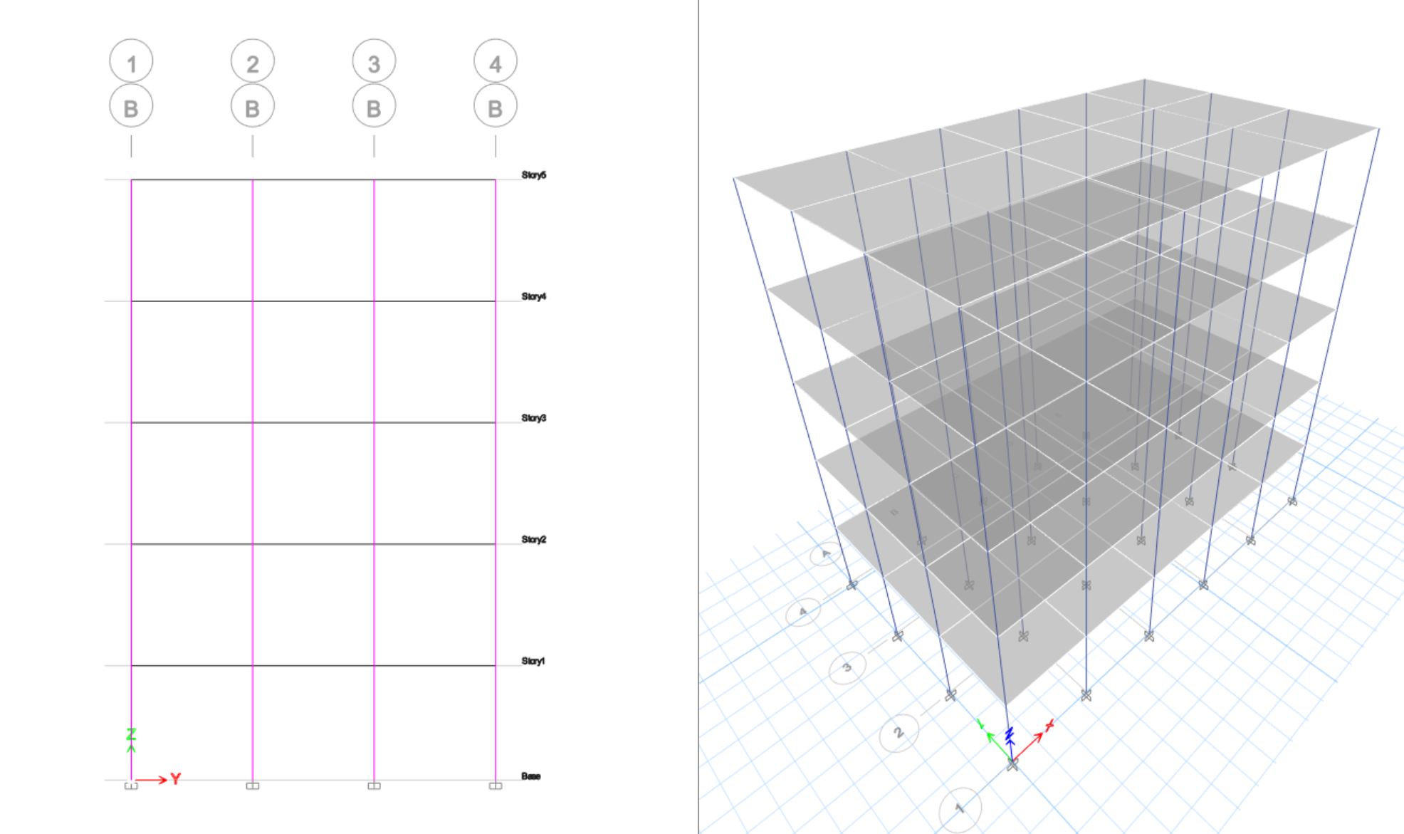

Dear Team,
Is there any option of viewing a particular elevation in the case of 3d building as we have in Etabs as shown in the figure below?
Because it is very hard to apply loads on inner beams or columns in the case of 3d buildings in STKO.
Zeeshan

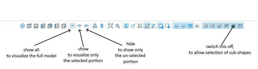

You can select the particular frame you are interested in (using the sub-selection)
and then use the Show command to visualize only your selection.
When you are done, you can go back to the full-model using the ShowAll command
