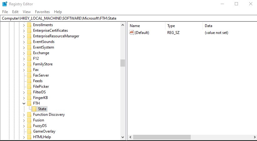

This is really strange. If the first time you read the DB it was saved in a SSD (Solid State Disk) and then you moved it into a standard HDD, then it would make sense.
If this is not the case, try to open the System Registry Editor (type the regedit command in the windows search bar)
Then navitate to: \HKEY_LOCAL_MACHINE\SOFTWARE\Microsoft\FTH\State
Post a screenshot of what appears on the right when you click on State
Re: Slow Database Loading
No, it's all on HDD from start to finish. Here is the screenshot:
- regedit.jpg (42.45 KiB) Viewed 5096 times
