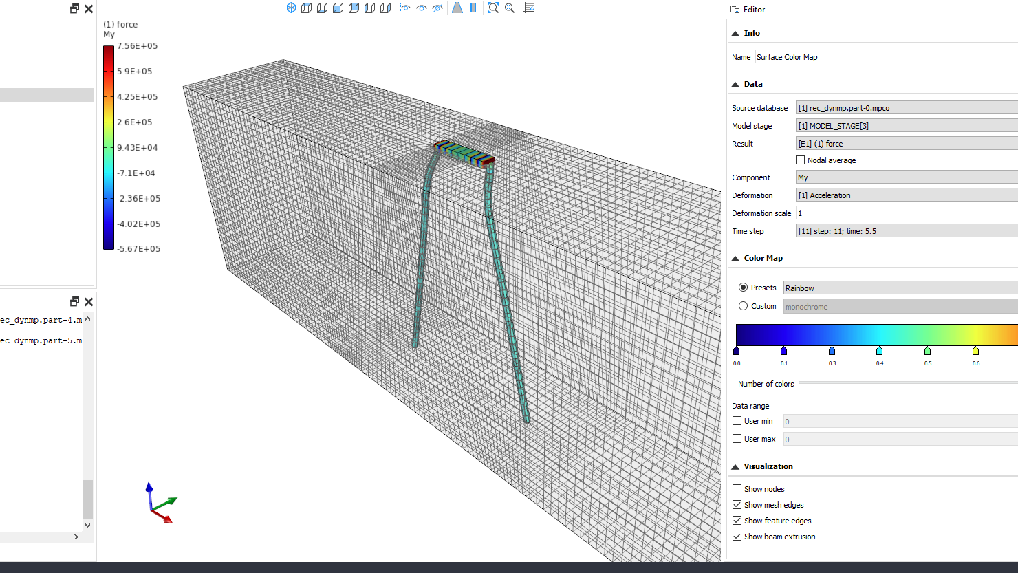

I have some issues with the recorder after some of the latest updates. I
I have a model consisting of solids, beams and interactions. Applying the same procedures as always, I create a selection set containing beams and solids and a region with that selection set. Then I specify that region in the recorder.
I am expecting solids, beams and nodes to be recorded. However, only solids and nodes are recorded.
What is interesting is that for older models, everything works fine with the updated versions, unless I make changes to the geometry (I have checked that the new geometry is in fact added to the selection sets),
What am I doing wrong?
The model is attached.

I see the beams:
Probably I did not understand what is that you cannot see

No, you understood the problem, but I just now figured out the issue. I accidentally boxed out the beam element results in the recorder command.. :oops: Sorry for the inconvenience!
