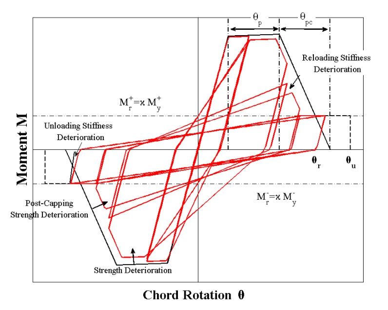

After I finished my analysis, how could I get the result of plastic hinges?
I create plastic hinge by uniaxialMaterial ModIMKPeakOriented. There is backbone curve and hysteresis loop in this material.
How could I get the data and the result?
Here is my model. Any advices and helps that you provide are highly appreciated.

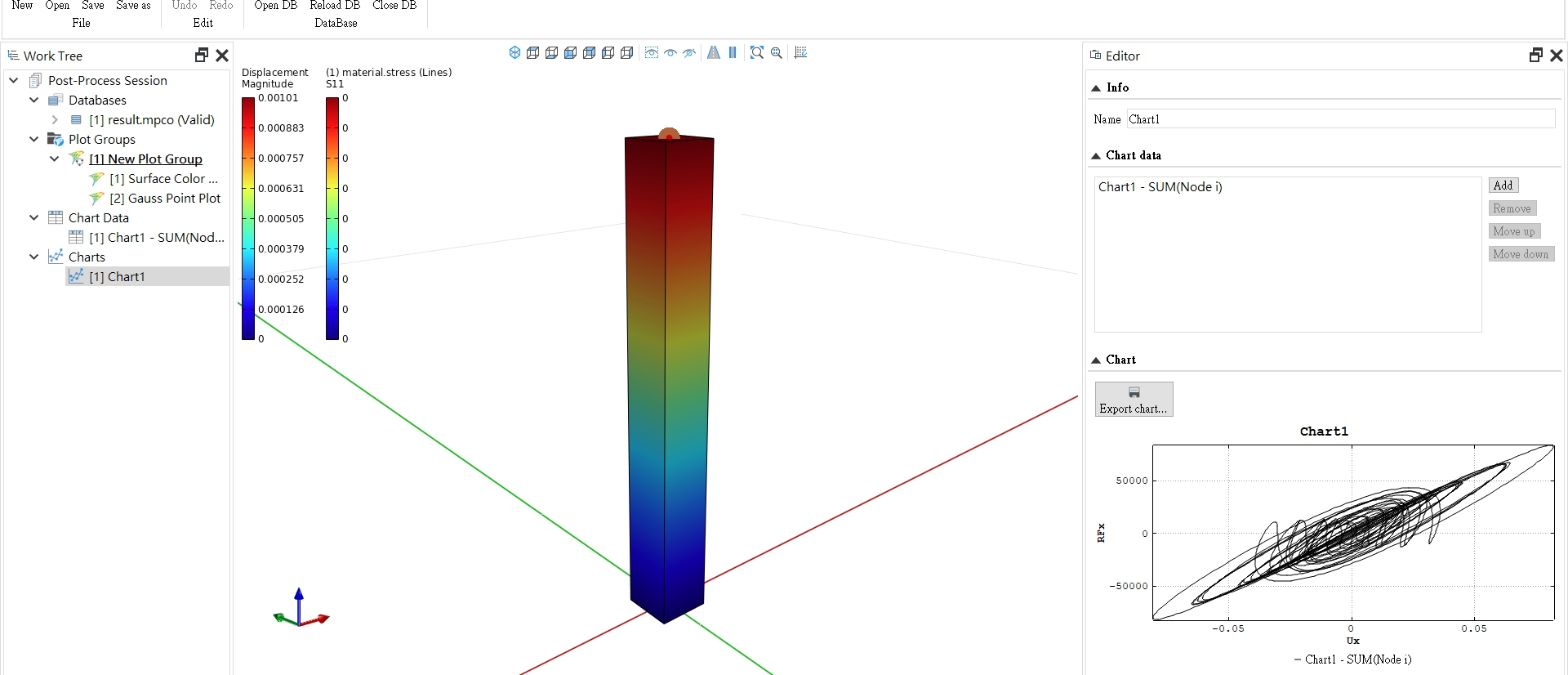

Dear STKO Team:
Thank you for your help.( I named my nickname casually
But I still can't get the results of plastic hinges by using the gauss point plot.
I don't know why there is no data in gauss point plot like the following picture. I want the data of the backbone curve and hysteresis loop.
By the way, when I checked the displacement and reaction force, the result looks weird. Is there any wrong in my model?

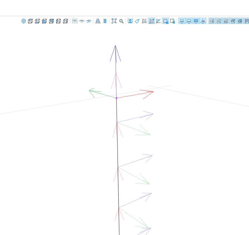

By the way, I have asked similar question here before. You said that the plastic behavior depends on the local axes defined, and in STKO/OpenSees X local axis was always along the longitudinal deirection. That was why I set zerolength in 6 direction (Mx), and the following picture shows the local axes of the column. The flexural degree of freedom is Y local axis (5) and Z local axis (6).

By default the zeroLength element (as any other "interaction" in STKO) uses the global axes, unless you assing a new user-defined localAxes to them.
Then if you model your column drawing the zero-length elements manually, they will use (by default) the global axes, so the bending DOFs of the plastic hinge will coincide with the global rotational DOFs, so 4 (Rx) and 5 (Ry), while 6(Rz) will be the torsional DOF.
If instead you use a HingedBeam element, the zeroLength for the plastic hinges will use the same local axes used by the inner beam element. So in you picture, the local X is alligned with the beam column, while the bending axes are the local Y and local Z. More specifically the local rotational DOF about the local Y axis correspond to the global Ry rotation. While the local rotational DOF about the local Z axis corresponds to the global Rx rotation. So in this case the bending DOFs for your hinges are 5 (Ry) and 6(Rz) because they refer to the local coordinate system of the beam, while 4(Rx) is now the torsional DOF.
