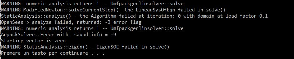

there is no .mpco file because you have warnings shown in the figure below. The model is unstable for mainly two reasons. First of all, if you use compound, node are overlapped and not merged, so a lot of elements are free. We suggest to merge elements of the model in order to delete overlapped elements.
Second of all, there are no properties and/or conditions applied on interaction.
See the attached file, we suppose interaction conditions, but you can modify them as you need.
In addition, we suggest to use Penalty Method with plane constrain.
Please, let us know if you have other problems.

Thank you for your insightful response! It is much appreciated. I noticed that my OpenSees command window was not showing any warnings because it was version 3.2.0 that I had transferred in my STKO folder manually. Placing version 3.0.3 instead reproduced the warning messages. Does this issue of overlapping and merging nodes occur in STKO only? I see similar warnings in a different bridge model I had developed in OpenSees.

Re: Unable to produce MPCO file for post processing after running analysis
Dear User,
If you don't see any warning with version 3.2.0, it might be a side effect: If you donwloaded OpenSees 3.2.0 from the official opensees website, there where 2 bugs related with fiber section and elastic section. So probably you started opensees and you did not see any output because there was a crash in opensees.
If you want to use version 3.2.0, there is a precompiled version with those bugs fixed, hosted at the PUCP university of Perù at the following page:
There you will find a link to download the installer for the opensees 3.2.0 sequential and parallel solvers:
https://drive.google.com/file/d/1ETGQ3Y ... sp=sharing
If you donwload the lastest version of STKO, it will automatically detect those solvers without doing anything manually.
You can find all relevant tutorials in our webinars here:
https://asdeasoft.net/?stkowebinars-for-opensees
There you can access all video recordings and files of our previous webinars
The interaction is just a CAD entity. If you do not assign any ElementProperty or Condition it will not produce anything in OpenSees. For example if you want to create a equal dof constraint, you first create the interaction, then in condition you create a new mp.equalDof and assign it to the interaction.I did not understand what you meant by no properties applied on interaction. Could you provide me more details? An example or tutorial video of this would be excellent.
