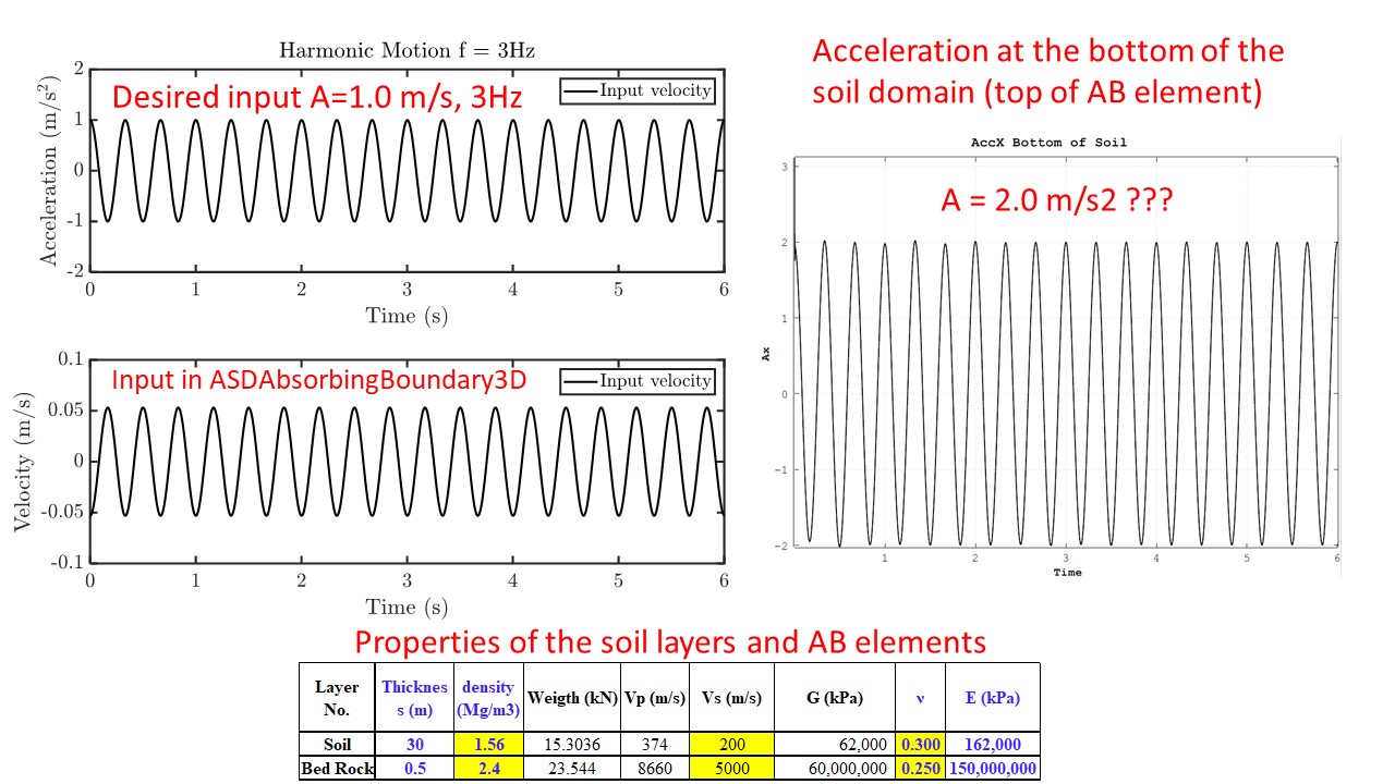

I must apologize, but I have to ask the same question again as I still don't understand where the discrepancy is coming from.
In my model I have 240mx240m elastic soil domain, 30 meters thick soil (Vs = 200 m/s) with 0.5 meter very stiff rock layer at the base (Vs = 5000 m/s) - model is attached. When I apply the harmonic motion of 3Hz with amplitude of 1.0 m/s2 (I input the velocity in the AB element), what soil is actually seeing at the base layer is acceleration of amplitude of 2.0 m/s2 (see figure below - figure also gives the parameters of the rock layer also used in AB elements). I am pretty sure I converted acceleration to velocity correctly and that my input parameters are correct, and I still can't figure out why is my acceleration at the base of the soil not the one that corresponds to input velocity.
Can you please let me know your thoughts? I would really appreciate if we can get to the bottom of this.

Post by STKO Team » Fri Jan 28, 2022 3:28 pm

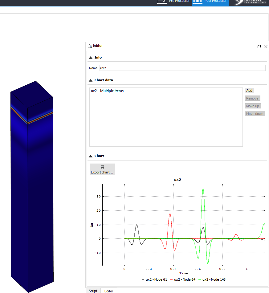

It makes sense because you are measuring the acceleration at the interface between the bedrock and the soil.
When the wave passes the interface between 2 different materials, it gets amplified, and part of it reflected back.
Keep in mind that at the free surface (E = 0) you will see an amplification of 2.
So ideally you should see:
1 at the base of the bedrock
almost 2 at the interface between the bedrock and the soil (because the soil stiffness is negligible wrt the bedrock stiffness)
4 st the top free surface
Of course, you won't see exactly those values for some reasons:
  • The bedrock layer is too thin, even smaller than the wavelength of your input. So while the wave is still entering, it already got reflected from the bedrock-soil interface. So you will see almost the identical response (2) also at the base of the bedrock
  • You are using multiple waves, so the input gets added to the waves coming back. It's hard to do a benchmark in this way.
  • You have damping.
If you want to understand how it works in the case of 2 layers (bedrock and soil), you should use a simple wavelet (so you have only 3 waves coming in, and when they will come back there are no other waves, so it's easy to read).
Also, you have to make sure that each layer is larger than the wavelength of your input.
As an example, download the files from webinar #24
Implicit-Explicit Contact Element Applied Examples: soil-foundation interaction and RC structures
use the file in webinar_contact_implex_14_10_2021\absorbing\T05_abs_3d_2_layers
You should see an output like this (as you can see the base is exactly 1g amplitude of ricker wavelet as per input, and at the interface and at the top you can see amplifications)

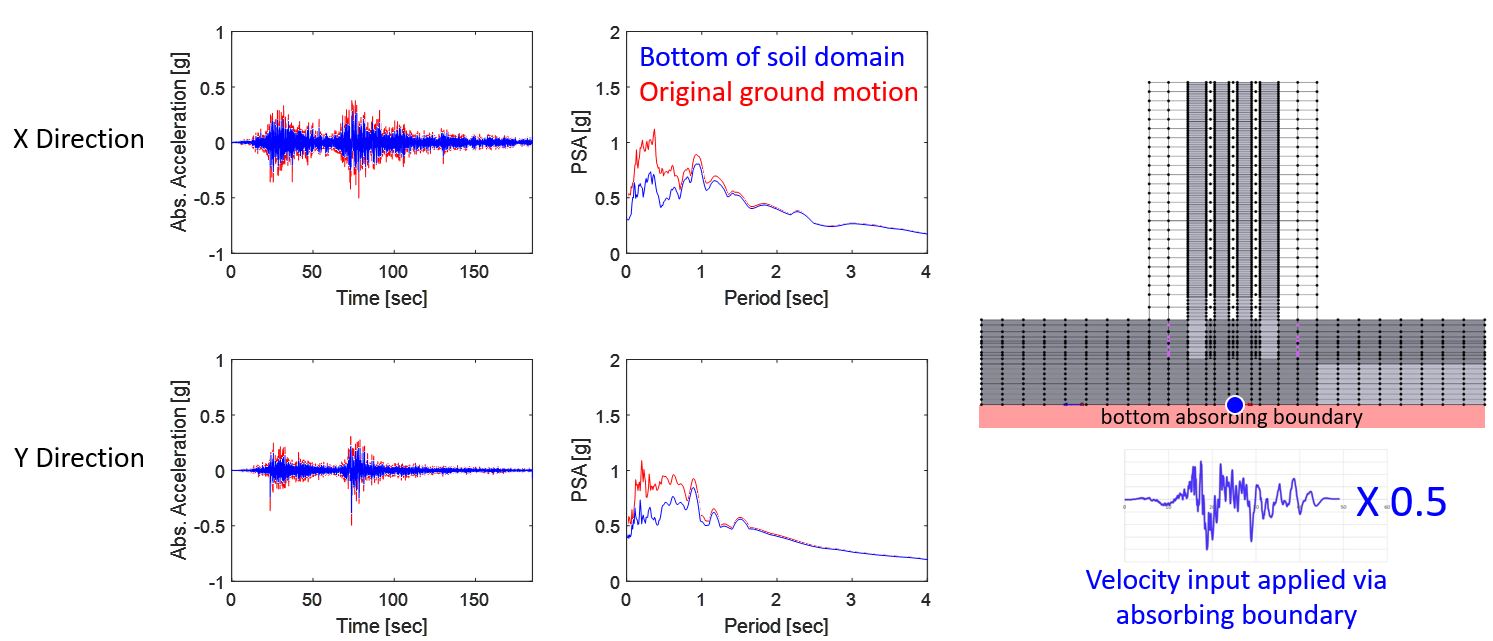

Hello, I am doing SSI analysis of a tall building. I applied the ground motion in the SSI model by first converting the record acceleration to velocity and then divided by 2.0 to get the correct input (we discussed this before). I was plotting acceleration response at the bottom of the soil domain and compared them to the original input (see below). As you can see, the spectral response matches pretty well for periods larger than 1.5 seconds. However, for periods smaller than 1.0 seconds, it seems that the spectral acceleration response at the bottom of the soil domain (top of the absorbing boundary) is reduced by approximately 30%. It seems like something in the model "damps out" the higher frequencies of the ground motion.
At first I suspected that my mesh is too large, so I tried mesh size sensitivity (you can see the current mesh in the screenshot) and it didnt make much of a difference. However, I am still not sure if I should be trying even smaller mesh and if there is any recommendations about the mesh size, if the mesh is the issue at the first place.
I was wondering if you can provide me with your insight into this issue and an advice on how to resolve it. Is there anything else that I should be trying besides the mesh size?
The mesh can be one of the reasons.
Of course, you cannot expect to capture extremely high frequencies well, due to the constraint on the mesh size:
critical mesh size <= max_wave_length / 8 (or 10).
That is: critical mesh size <= Vs/fmax/8 (it means: at least 8 elements per wave-length)
If you are sure about the above-mentioned constraint, check what else can damp those higher-frequencies:
are you using rayleigh damping?
are you using a transient integrator with numerical damping?
