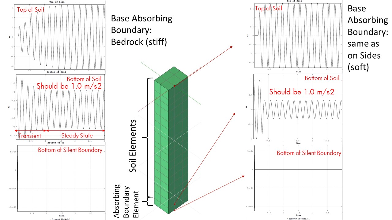

Yes, I have applied velocity history that correspond to sinusoidal acceleration with magnitude of 1.0 m/s2.
If the material properties (G, Poisson, and rho) of your absorbing boundary at the bottom match the ones of the soil model, you should have exactly the input you want.
This is interesting. Why does a material property of the absorbing boundary affect the acceleration applied at the bottom of the soil? That means that there should be some kind of relationship between the input and the output, but per the previous quote, it is just a velocity and acceleration, without considering properties of the boundary at the bottom. Maybe I am missing something. Also, please see the explanation about the model at the bottom.
In this case, since you are applying the input as a boundary traction (your input velocity transformed to boundary traction by the ASDAbsorbingElement) the accelerations will be absolute, that's why you should see your acceleration at the base and not zero.
OK, so just to triple check. When using absorbing boundary at the bottom to apply ground motions by applying tractions via velocity, you get absolute accelerations as output. Please confirm.
If your share your model here I will check what's wrong.
Thank you so much. Attached is the same model as the big domain (240m x 240m), but I reduced it only to 2mx2m because of the runtime (big model takes an entire day on 25 cores). I checked and the results are identical between to big domain model and the small domain model, which is good news meaning that absorbing boundaries work the same way for both models. If you can find a mistake in the small model, it should work for the big model as well.
Please note the following regarding the model attached: it has two materials for absorbing boundary at the bottom: a) same as absorbing boundary on the sides, and b) the one called "bedrock", which is stiffer and corresponds to rock at the base of the domain. Interestingly, input motion at the bottom of the soil column is not the same when I change between these two materials assigned to the base absorbing boundary element. (see attached picture).
It would be great if you can figure out what is the issue. I spent a lot of time playing with this. I just trying to apply 5Hz sinusoidal motion to the soil and compare it with theoretical solution.

Yes, I have applied velocity history that corresponds to sinusoidal acceleration with a magnitude of 1.0 m/s2
What you input for velocity is not exactly the derivative of a sin acceleration of 5 Hz frequency. In fact, the initial slope of your velocity should grow slowly, instead, in your case, the initial slope is not 0, so it generates that strange peak at the beginning.
Use this:
acc = amplitude*sin(time*2*pi*frequency);
vel = -amplitude*cos(2*pi*frequency*time)./(2*pi*frequency);
You input a velocity, and the absorbing boundary converts it into an acceleration using the shear wave velocity (Vs = sqrt(G/rho)) and the mass density. If you use different material properties in the absorbing boundary and soil elements this won't work.
Yes, absolute accelerations
If you want to simulate the presence of bed rock, model a piece of it, and below that, use the absorbing boundaries matching those values. You have to follow one rule: the absorbing boundary you apply on a face of a soil domain should have the same material properties of that soil domain.
In our webinar about absorbing elements I also made an example with a layer of bedrock (it's like a multi.-layer soil column)
Regarding the strange behavior you see at the base
  1. If you fix the input velocity with the correct derivative of the sinusoidal function, you will see that the initial wave at the bottom has a maximum of 1, as you would expect
  2. Now you will notice that after 2 waves the following waves are smaller. This is perfectly normal:
    Once the first waves hit the top free surface, they are reflected back towards the bottom, but due to a time shift based on the height of the soil column, they will sum/subtract to the new waves that are "going in" from the input time series.
    You can verify this, randomly changing the height of the column: the higher it is, the more waves with a correct peak of 1 you will see.
