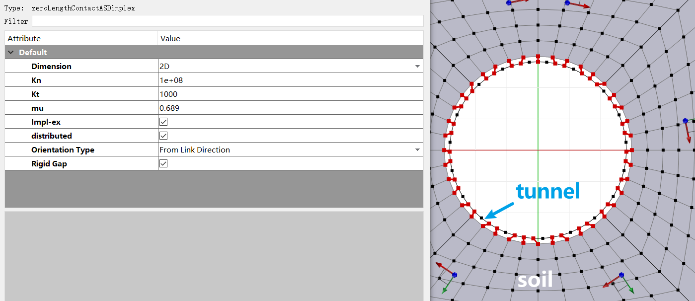

I'm facing an issue where the same model fails to converge when the interaction type changes from equalDOF to ZeroLengthImplexASDContact.I’m having difficulty identifying what might be wrong with the parameters. I think the key parameter to focus on is kn. For my analysis, I use the third-order average stiffness of the model, as shown in Figure 1.

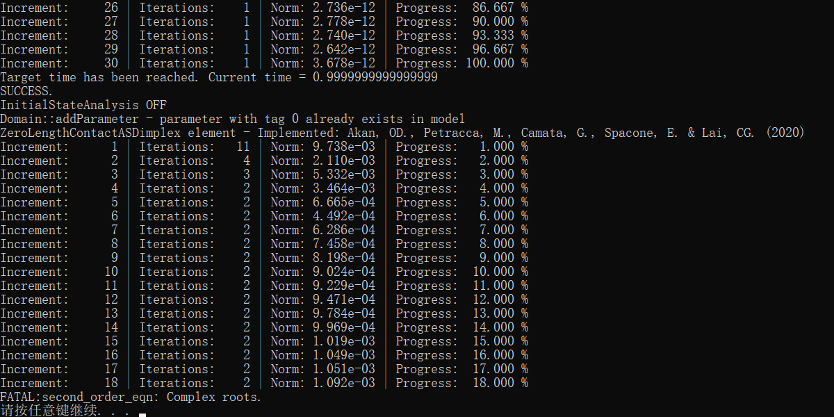

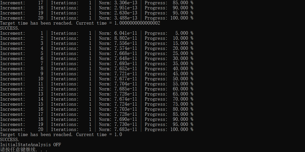

Additionally, in other models with multiple analysis stages, including an initial analysis before the tunnel addition stage, the model often fails to progress when ZeroLengthImplexASDContact elements are introduced (Figure 2), or faces a complex root error occurs (Figure 3). In some cases, the calculation even terminates prematurely before entering the stage (Figure 4).

I think the error of complex root comes from a material model.
However, can you share your file to have a look?

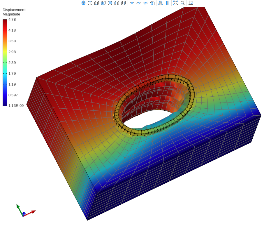

Post by STKO Team » Tue Aug 27, 2024 12:22 pm
In my case, your first model converges when I remove the -distributed option from the contact. That option is useful when your Kt and Kn are not penalty stiffnesses but real stiffnesses.
However, I see penetration in some places:
This happens because you are modeling the tunnel as beams, and the real contact area of the beam is not physically represented. Probably it would be better to model the tunnel with solid elements to properly define the contact surfaces

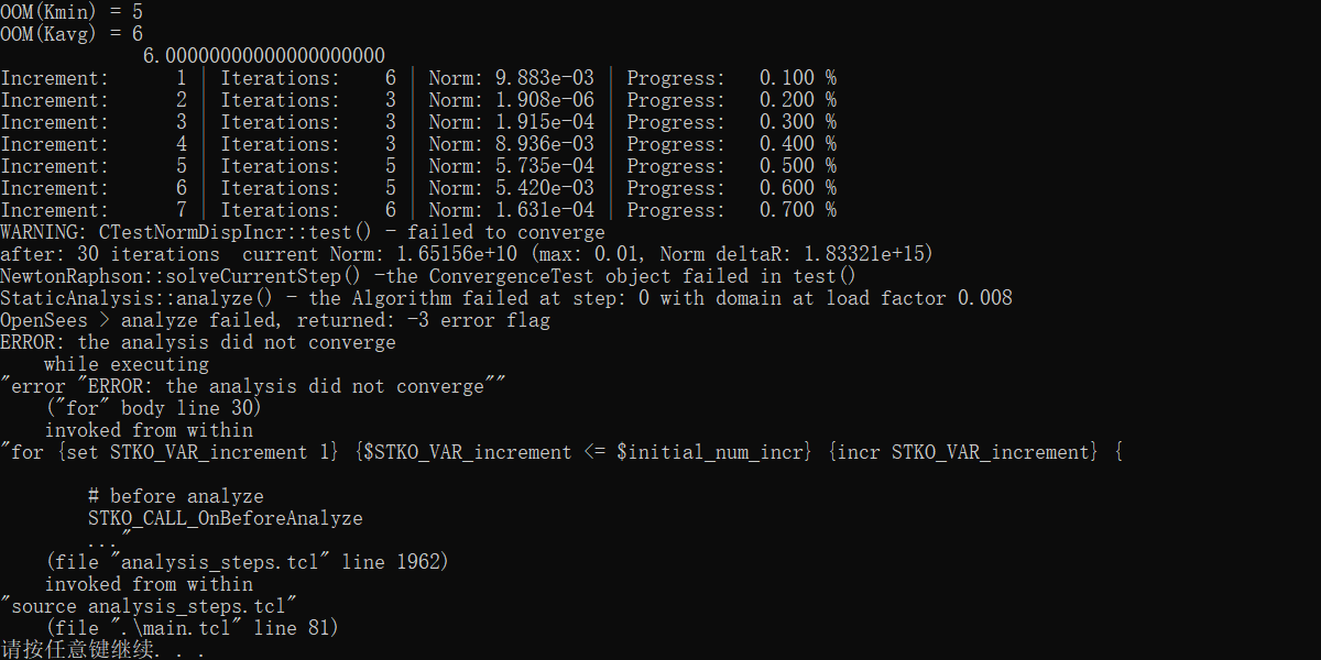

I made a comparison using the complex roots model.

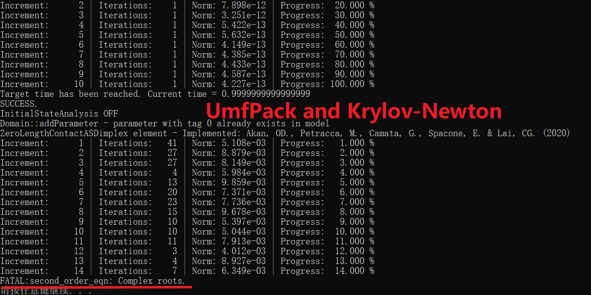

When I chose UmfPack and Krylov-Newton, it showed complex roots. Figure1.

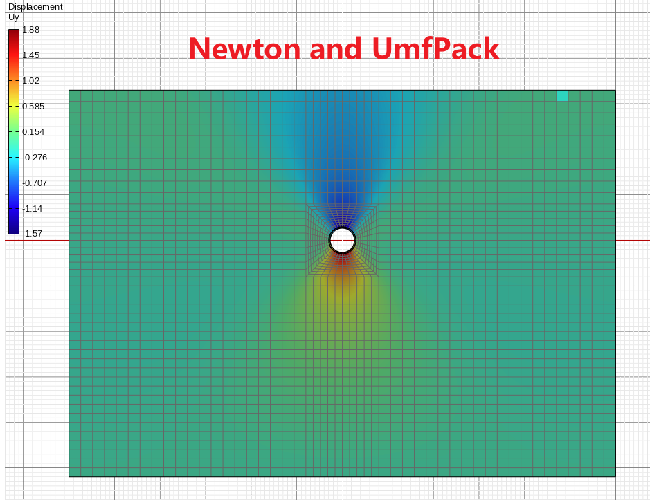

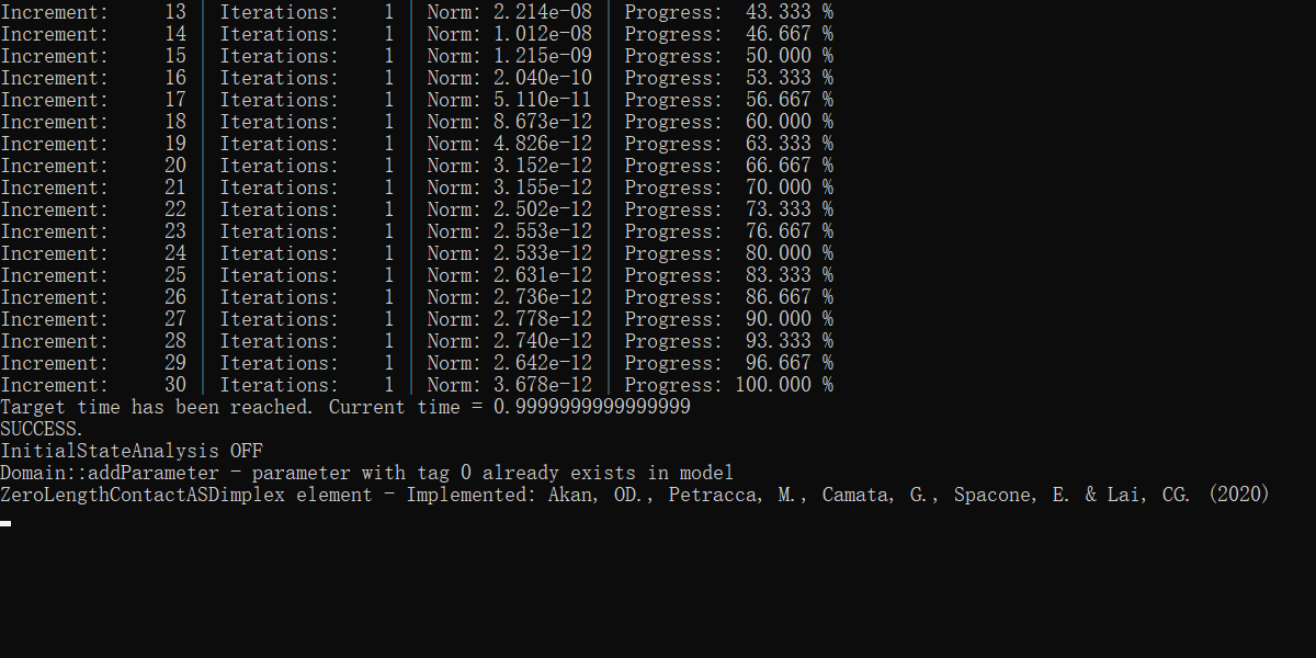

When I chose UmfPack and Newton, it converged and the uy-max was 1.88mm. Figure 2.
When I chose SparseSYM and Krylov-Newton, it also converged, but the uy-max was 5.4mm. Figure 3.
So, which result should I trust?

Re: equal DOF and ZeroLengthImplexContact
Post by STKO Team » Wed Aug 28, 2024 8:17 am
This can make sense: A different algorithm (Krylov-Newton vs Newton) can lead to different guess (trial displacement increments) during iterations. If one of them leads to un-realistic trial displacements while iterating for convergence, the material may not be able to solve the constitutive equations (complex roots in your case).
This is strange. While those combinations can give different "paths" during iterations in each step, the converged solution should be the same, because it cannot depend on the stiffness matrix or how it is factorized.
What I see here is that you are using very few time-steps for a problem involving contact.
So there might be 2 reasons for that:
1) You are using a convergence tolerance that is too high, so that also wrong solutions will be accepted
2) You are using some sort of Explicit algorithm (for example IMPLEX in contact), that require small time steps
