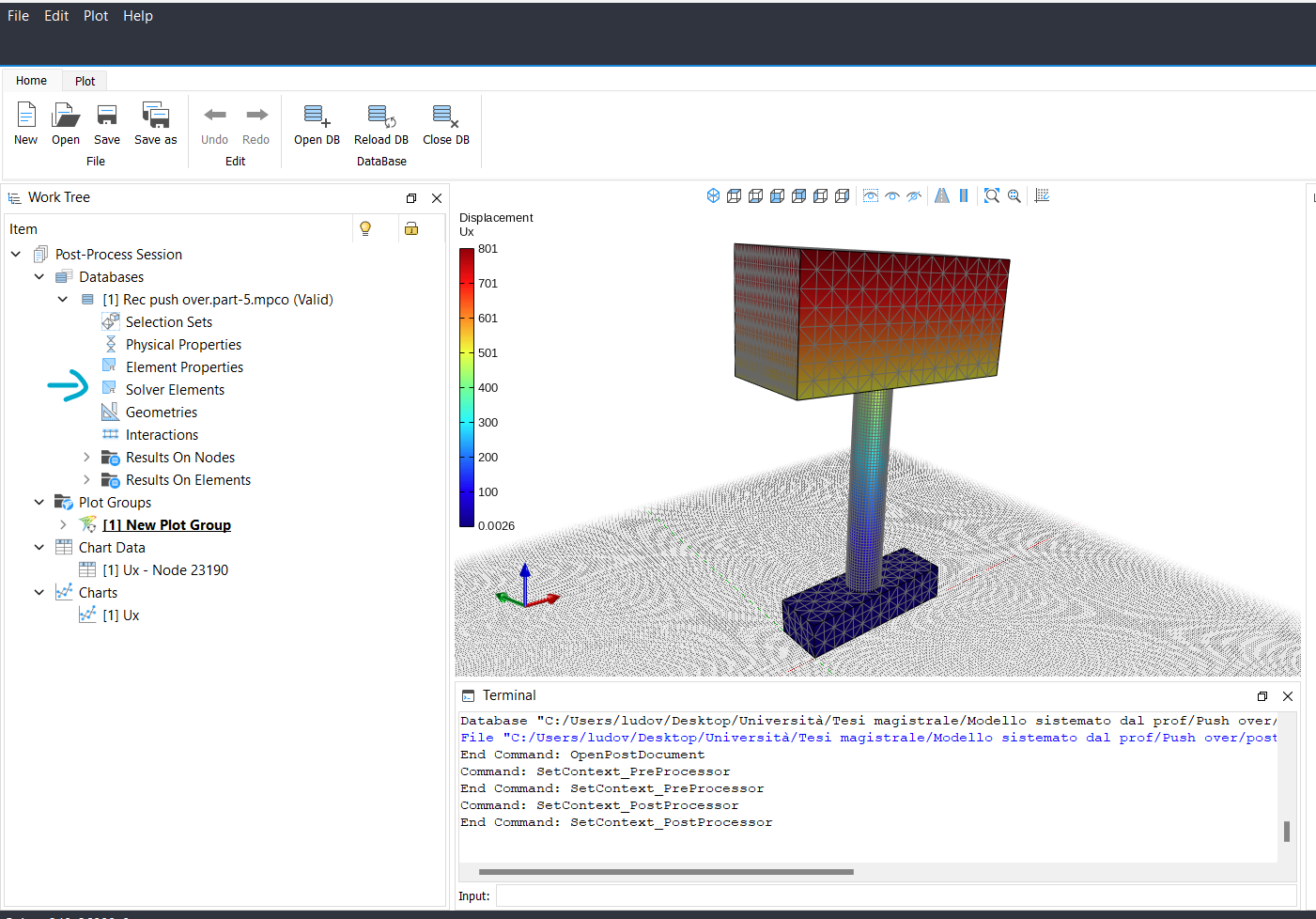

Hi STKO team,
in the recorder I don't have the drop-down menu in any item, so I can't select the elements I need the results of.
I hope someone can help me asap,
Thank you so much!
Screenshot 2024-07-25 175500.png (35.83 KiB) Viewed 4012 times

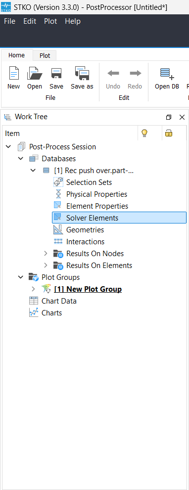

Here I can't open it and select the elements
Screenshot 2024-08-03 130144.png (302.76 KiB) Viewed 3853 times

Re: Drop down menù of the recorder items
Post by STKO Team » Mon Aug 05, 2024 8:53 am
If you can't select element and related info in the post processor it means that either you did not create the model in the STKO pre processor or you copies the MPCO files in a different location without the associated MPCO.CDATA files (those small files are required for those extra information)

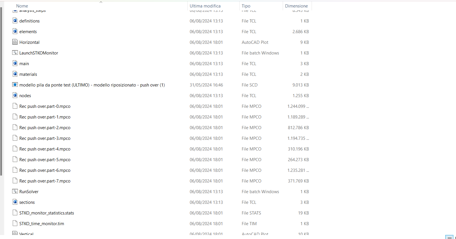

I understand, so I don't have the associated mpco.cdata files between the analysis files but I didn't move anything. I've just ran the analysis and saved it in the same folder of the scd file. I created the model in STKO pre processor.
In the attachment the screenshot of the analysis files.
Screenshot 2024-08-06 19.03.33.png (78.5 KiB) Viewed 3785 times
Post by STKO Team » Thu Aug 08, 2024 7:38 am
OK, so probably you are running the analysis inside a folder where OpenSees and STKO have right to write, but not the python interpreter inside STKO (which is the one writing the MPCO.CDATA files).
What is the directory in which you are writing the tcl files?
Can you try to write the tcl files inside another directory?
