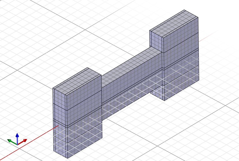

Hi, I am trying to generate HEXA elements in my model.
I imported the geometry from an igs file, and then I merged the elements.
I am not able to generate hexa elements.
Could you help me point out what I'm missing?
Thanks.
DRB STKO Model RevB.zip
(543.75 KiB) Downloaded 153 times
Re: Getting only Tetra element in mesh
Post by kesavapraba » Tue Jul 16, 2024 4:14 am
Hi, It seems either your geometry file is corrupted or there is some inconsistency in the geometry shapes merge process. I did a clean geometry of the concrete region of your model in STKO itseld. It works now. Please see the attached figure and file.
DRB STKO Model RevB_modified.zip
(645.74 KiB) Downloaded 171 times
nmorabowen
Posts: 5
Joined: Thu May 16, 2024 3:52 am
Post by nmorabowen » Tue Jul 16, 2024 2:39 pm
Thank you for your time!, could you please tell me how did you clean up the geometry?
Post by kesavapraba » Wed Jul 17, 2024 9:42 am
Hi, In your case I redrew the geometry considering the front face after exploding the geometry multiple times. But, the real issue is that sometime there can be overlapping muti-faces/edges, which can prevent proper meshing. It can happen during import from other CAD software - you need to be aware of it. My experience is that import/export is not 100% perfect between different software!Please check the meshing right after importing the geometry.
