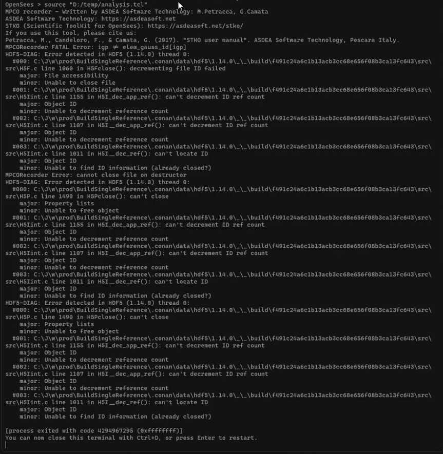

I've attached a screen shot of the error I am getting and also an example file. Note that if the mpco recorder is removed and the node recorder used instead it runs fine (I couldn't seem to attach a text file).

It's a problem with the zeroLengthSection: it does not format the output in such a way that the MPCO Recorder is able to understand the shape of the fiber section. We just changed the code and will do a Pull Request to the OpenSees Source code.
In the meantime, instead of a zeroLength section, use a unit-length beam element. In this way its rotation will be equal tot the curvature
