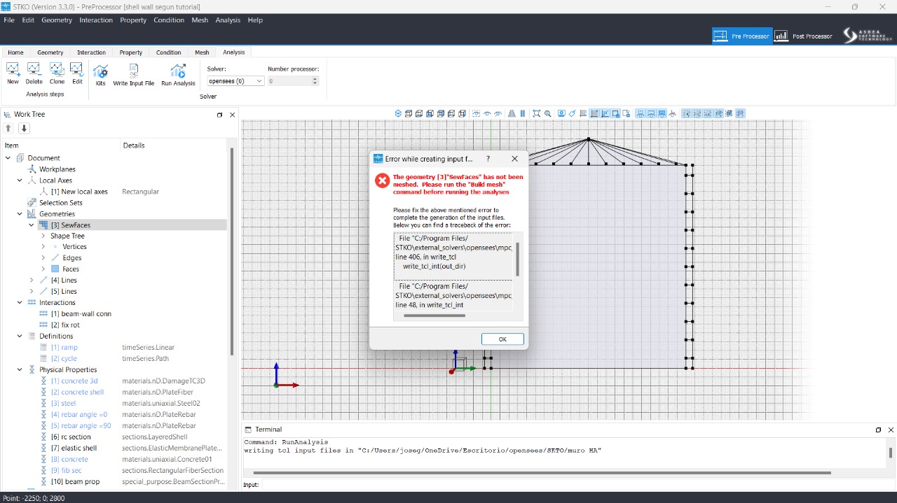

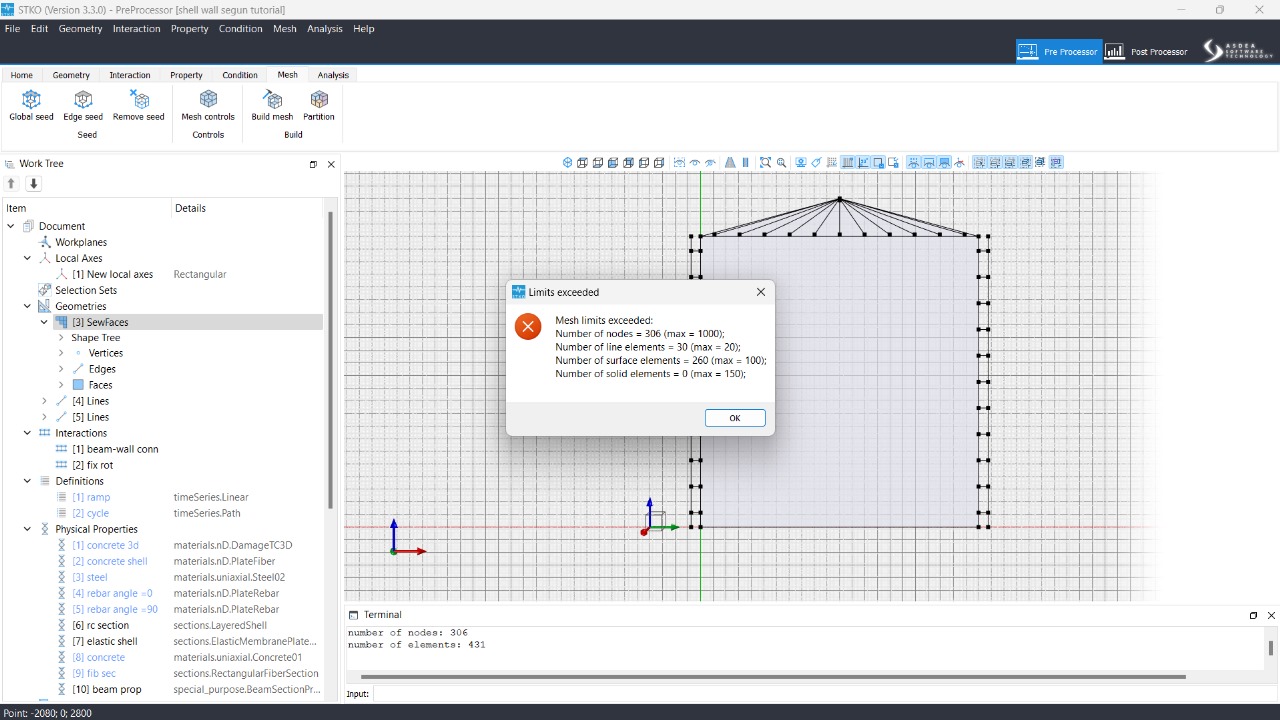

stko team I am a beginner and I was making the second model of the STKO E-Learning Course tutorial - Modeling a Reinforced Concrete Frame Structure (english webinar and I had a problem at the end, I can't make mesh since it tells me to go over the allowed limit, I don't know how to delete the mesh to do it correctly. I attached the image and model.
- shell wall segun tutorial.zip
- (167.8 KiB) Downloaded 190 times
- error mesh.jpg (211.42 KiB) Viewed 3152 times
- error mesh2.jpg (219.39 KiB) Viewed 3152 times
Re: the geometry has not been meshed
Hi, Please check with ASDEA s.r.l about your STKO license type. Some types of licenses (free trial) have limitations of number of elements and meshing. Your write to the purchase team of ASDEA s.r.l

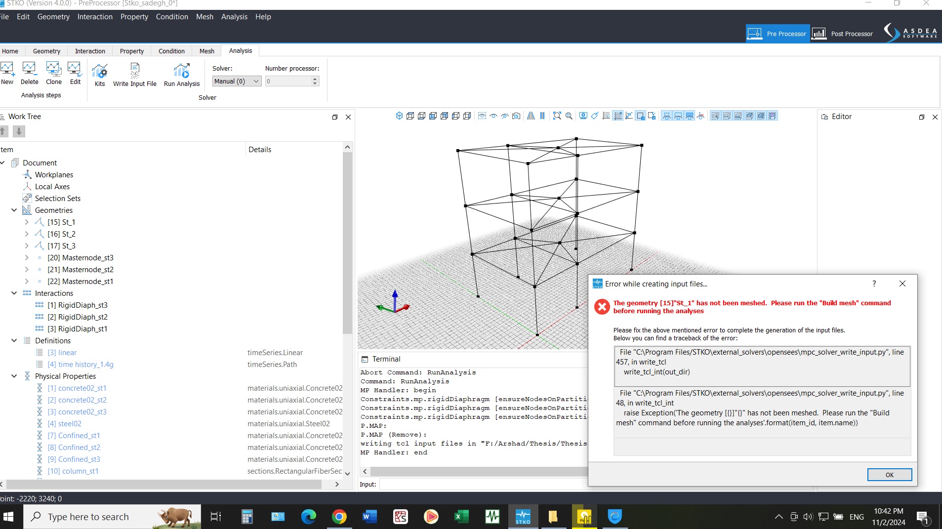

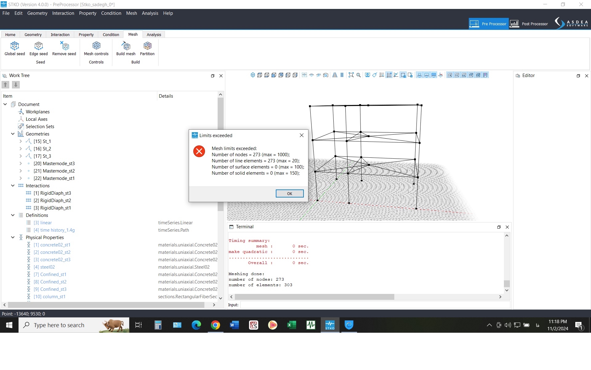

Dear STKO Support Team,
I am reaching out to seek assistance with an issue I am encountering while running an analysis in STKO. I am currently working on a model where I have encountered the following error message:
"The geometry [15] 'St_1' has not been meshed. Please run the 'Build Mesh' command before running the analysis."
Despite following the instructions and using the Build Mesh command to create a mesh for "St_1", I am still unable to proceed with the analysis. I have also checked for potential issues with the geometry and interactions, but the error persists.
Could you please provide guidance on how to resolve this error? Any advice or troubleshooting steps specific to this type of issue would be greatly appreciated.
Thank you for your support and assistance.
- STKO_error_2.jpg (388.26 KiB) Viewed 2423 times
- STKO_error.jpg (481.52 KiB) Viewed 2423 times
Hi, This is because you use trial version of the stko and don't use commerical license. Trial version limits the full capabillity of stko. You can contact the stko's purchase team for buying the license.
