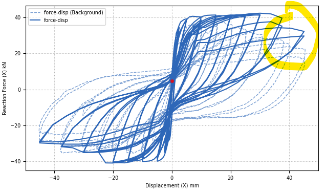

Hello, I am using STKO for the cycle analysis of a reinforced concrete column. I found that when I used ASDConcrete (6p) concrete material and steel02 material, my skeleton curve did not have a descending section. Could you please help me look at my model? Any help would be greatly appreciated!

Hi, The response does not soften since the rebar material (steel02) continually increases when the strain increases. In actual case, there will be fracture at a certain strain value (here I assumed it to be 5%, you should play it to get a good match in your cyclic curve), and the stress response has to be zero after the fracture. So, you can set a MinMax and Parallel material for Steel02 to obtain proper softening response. Please check the revised SCD file attached here and modify it accordingly.

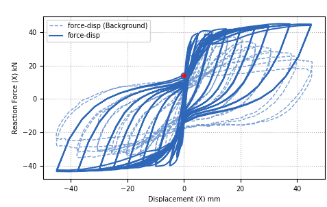

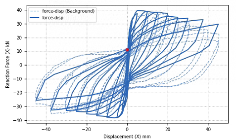

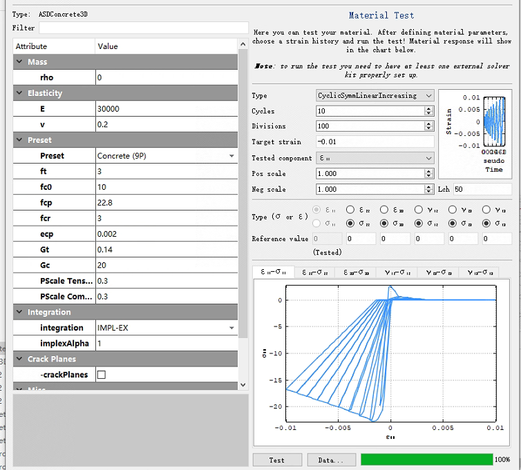

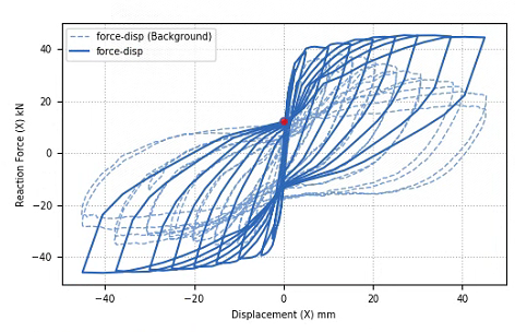

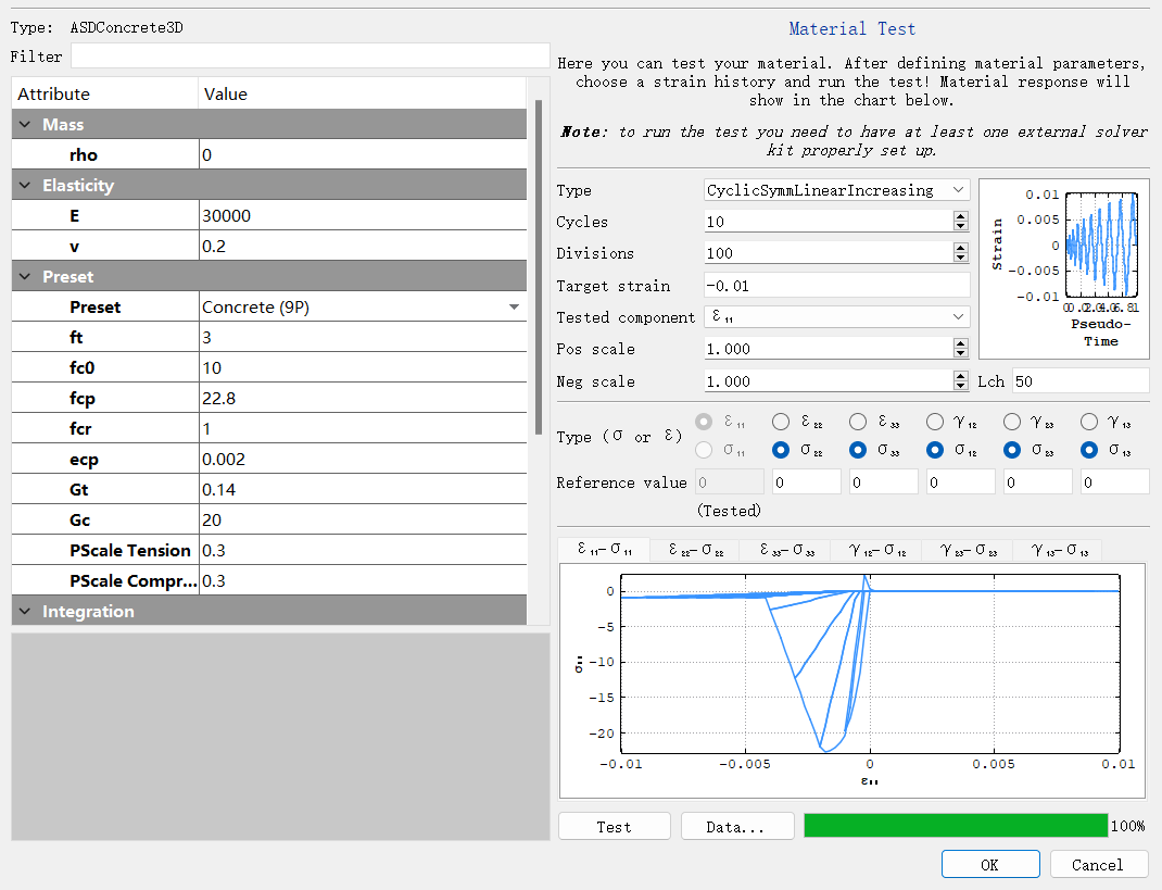

In addition, in my simulation, I found that when ASDConcrete (9p) and DamageTC3D were used respectively for concrete's constitutive materials, even though their parameter values were the same, hysteresis curves were very different. When ASDConcrete (9p) is used, there is no falling section of hysteresis curve, and when DamageTC3D is used, the falling section is more obvious. Is this because ASDConcrete (9p) does not consider damage, while DamageTC does? Can you explain this phenomenon?kesavapraba wrote: ↑Fri Apr 19, 2024 7:41 pmHi, The response does not soften since the rebar material (steel02) continually increases when the strain increases. In actual case, there will be fracture at a certain strain value (here I assumed it to be 5%, you should play it to get a good match in your cyclic curve), and the stress response has to be zero after the fracture. So, you can set a MinMax and Parallel material for Steel02 to obtain proper softening response. Please check the revised SCD file attached here and modify it accordingly.

Re: Why is there no descending section of the skeleton curve when I do the cyclic analysis of the column?
The DamageTC3D tends to overestimate damage in cyclic analysis.In addition, in my simulation, I found that when ASDConcrete (9p) and DamageTC3D were used respectively for concrete's constitutive materials, even though their parameter values were the same,
Note that the cyclic damage you see in the experimental test is due to multiple effects you may want to investigate.
First check steel slip and fracturing
Also, you should use a finer mesh for concrete. And the mesh for embedded rebars should be at least equal to the concrete or smaller, but not larger.
Finally, do not apply a displacement only on one edge, otherwise during the right-disp of the cycle it will pull your model, and since there you have nonlinear concrete, it may fracture in tension.
Apply a disp to the whole perimeter
Try first these modification with a monotonic test and then do the cyclic.

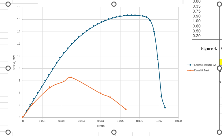

I learned from the analysis that the Gc/Gt doesn't affect the maximum strength. I am trying to test the compressive strength of the masonry prism, the maximum strength of the masonry prism by STKO was obtained twice or more than twice what we got in the test.
I attached the results of both STKO and the test here. Can you experience a compressive strength test of prism and say why the results are so high? (See attachment)
Did you try what I suggested in this other post?
viewtopic.php?f=54&t=2929&p=9100&hilit=Karishma#p9100
