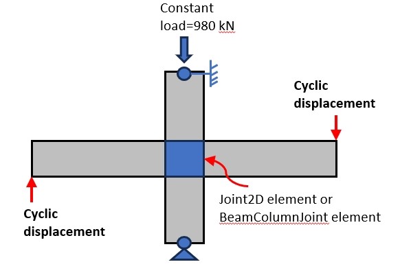

Firstly, I want to simulate the seismic response of a RC joint using STKO. The detailed introduction of this joint is shown in the following figure.
Below, I will send you two model files that I have already created. These two files are almost identical, except that the Joints use Joint2D element and BeamColumnJoint element respectively.
The model with Joint2D element can achieve perfect results, but the model with BeamColumnJoint element cannot. I don't know where the problem lies, I hope you can help me take a look.

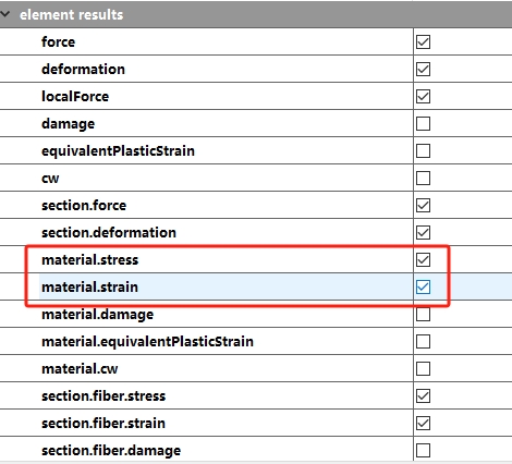

For force-displacement (moment-rotation) output, you need to enable "material.stress" and "material.strain" in MPCO recorder. The results can be seen from the post-processor Gauss plot. Each zeroLength element has one Gauss point, which can been seen at the location of zeroLength element.

Thank you very much for your reply. Here is the figure of the joint model.
Now I am attaching the two Joint models that I have built, where the model with Joint2D Element has a perfect result, but the model with BeamColumnJoint Element does not give the correct results. I don't know if there is an error in the BeamColumnJoint Element settings in my model. Looking forward to your help in looking at the models.

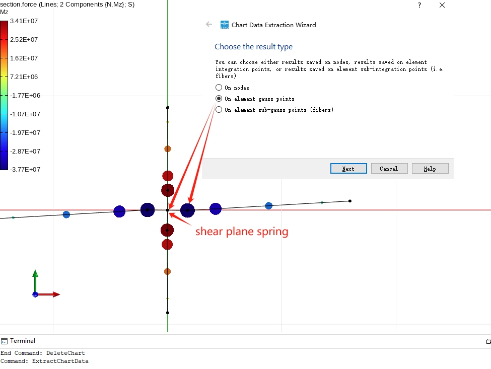

In addition, you said “For force-displacement (moment-rotation) output, you need to enable "material.stress" and "material.strain" in MPCO recorder. The results can be seen from the post-processor Gauss plot. Each zeroLength element has one Gauss point, which can been seen at the location of zeroLength element.” However, I checked the MPCO recorder option and select the material stress-strain output, but the Joint center point will not show the Gaussian integration point in post-processing, and I still can't select it to output the moment-rotation response of the Joint plane.I wonder if you could help me try it, I would appreciate it!
