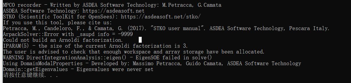

I can do gravity analysis on my model, but I get an error when doing modal analysis. What is the reason for this?
Re: the eigenvalue analysis is wrong
Post by kesavapraba » Tue Mar 26, 2024 1:40 pm
Hi, You can post a minimum example model here to find the exact cause for this error. Please check your model for any unconnected nodes/elements and also Eigen analysis settings.

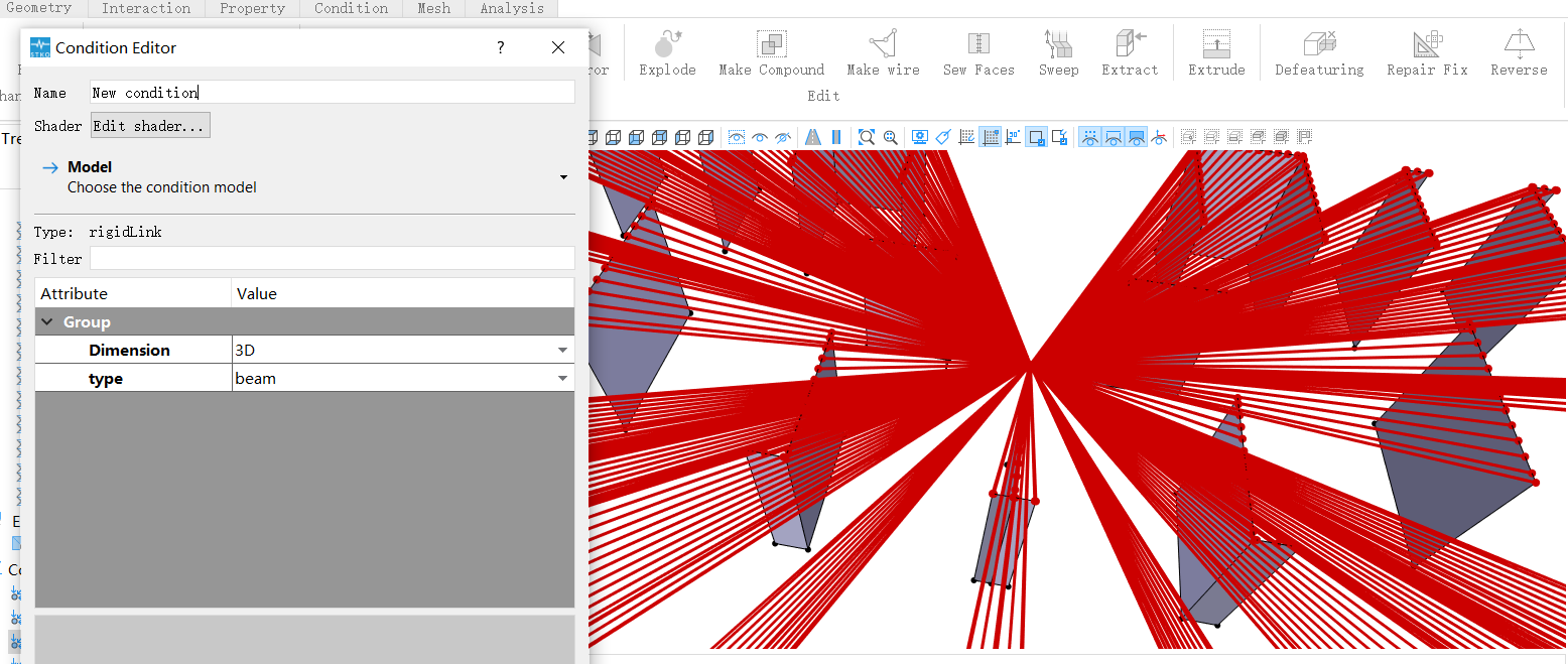

Can you tell me if it's the right thing to do?I want to use these operations to simulate a rigid floor slab.
Post by kesavapraba » Tue Apr 02, 2024 4:07 am
Hi, You should use rigidDiaphragm instead of rigidLink beam. rigidLink creates single MP constraint between one master and one slave node, however, rigidDiaphragm creates MP constraints accounting all the nodes in the interaction, resulting in rigid plate like behaviour for the floor.

Post by zly123 » Tue Apr 02, 2024 5:09 am

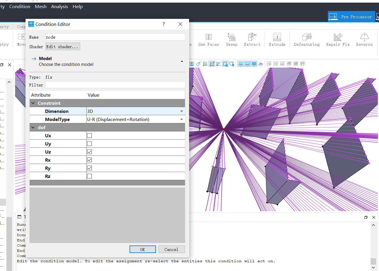

Do I still need to constrain the degrees of freedom of the control points?
Post by STKO Team » Thu Apr 04, 2024 9:55 am
The boundary conditions are fine.
In your model you don't need to fix the Uz,Rx,Ry DOFs of the master-floor nodes because the already belong to other elements.
