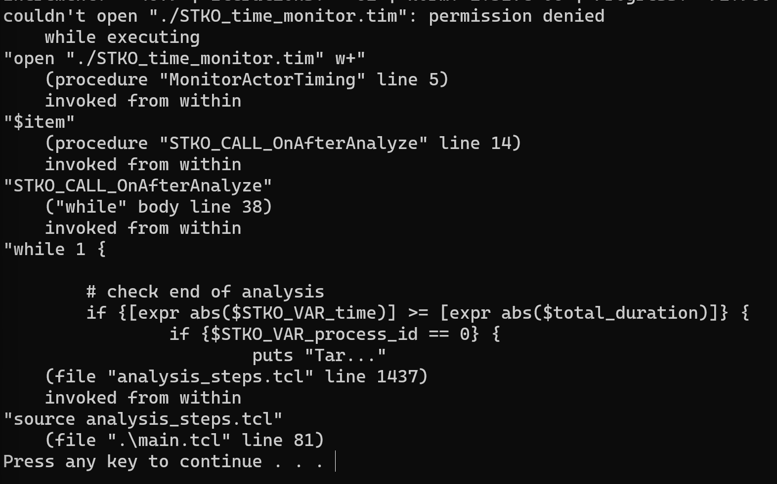

When I refine the mesh size, I get the message show on the picture. Can you give me some ideas why is this happenging.

Hi, Please check whether you have full write permission for the folder, where the file is located.

I believe I should have the permissions because with a larger mesh discretization, I don't get the message and the execution reaches 100%.

Hi, Can you please send me the model? I will try it out from my side.
