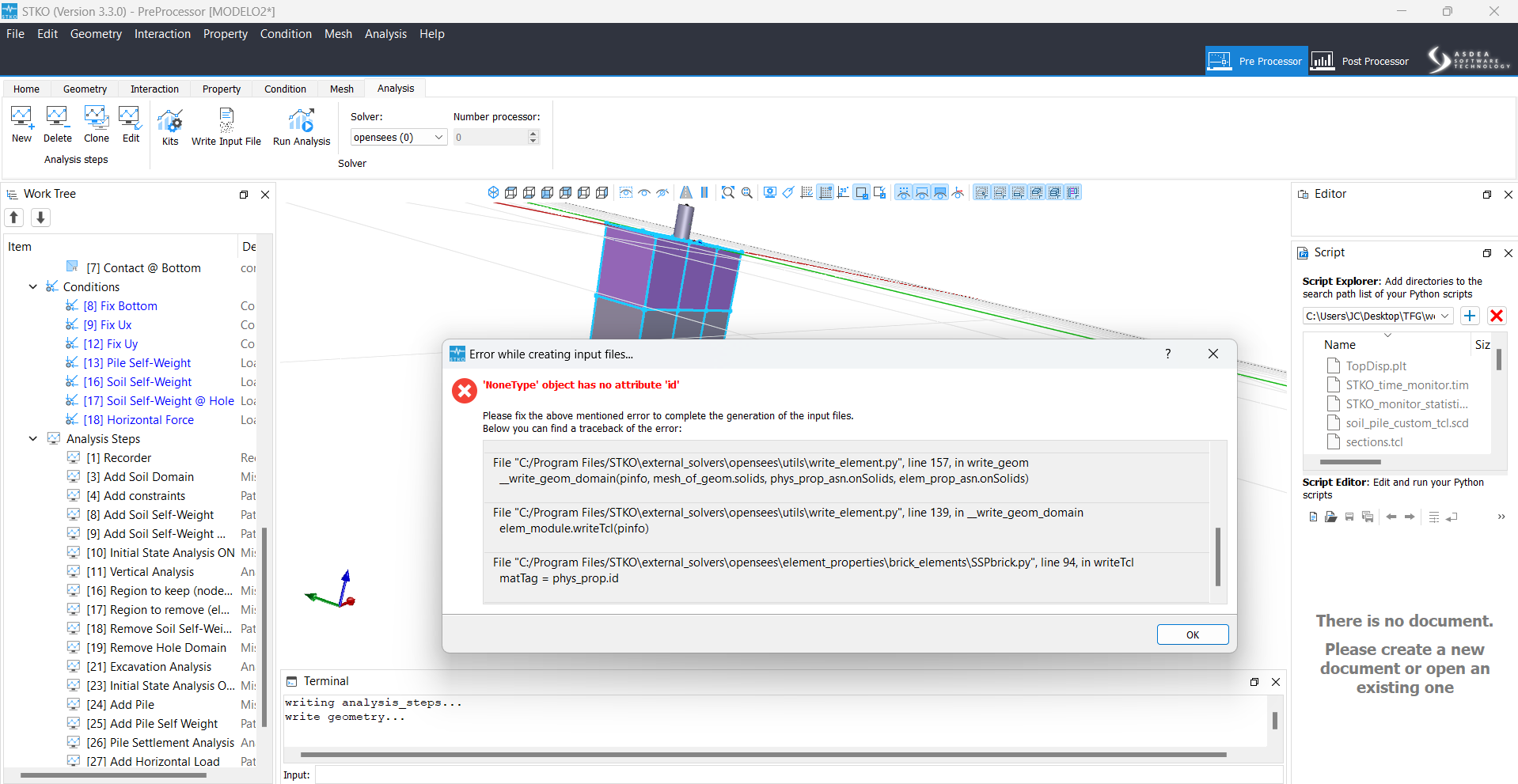

Is there any way to know exactly the element error? i know it should be a solid beacuse irs a brick element but cant find it
Hi im trying to replicate the pile soil interaction webinar. Its my first time using stko so im havng lots of isues. Can anybody explain me step by step since the design process? Id like to do the same but chnging the soil with diferents altitudes. Tanks!

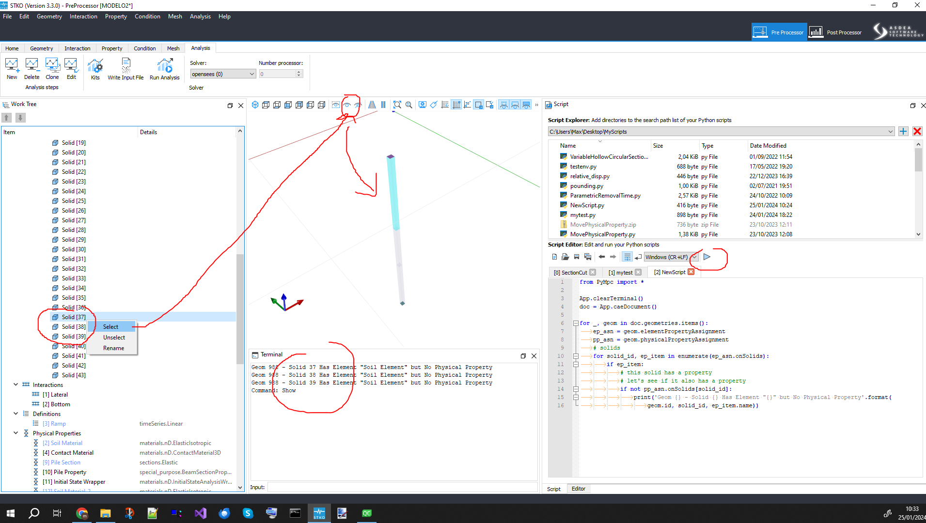

Post by STKO Team » Thu Jan 25, 2024 9:37 am
Use this script:
from PyMpc import *
App.clearTerminal()
doc = App.caeDocument()
for _, geom in doc.geometries.items():
	ep_asn = geom.elementPropertyAssignment
	pp_asn = geom.physicalPropertyAssignment
	# solids
	for solid_id, ep_item in enumerate(ep_asn.onSolids):
		if ep_item:
			# this solid has a property
			# let's see if it also has a property
			if not pp_asn.onSolids[solid_id]:
				print('Geom {} - Solid {} Has Element "{}" but No Physical Property'.format(
					geom.id, solid_id, ep_item.name))
It will print the sub-solids of all geometries that have an element property but no physical property (that is what is causing the error)

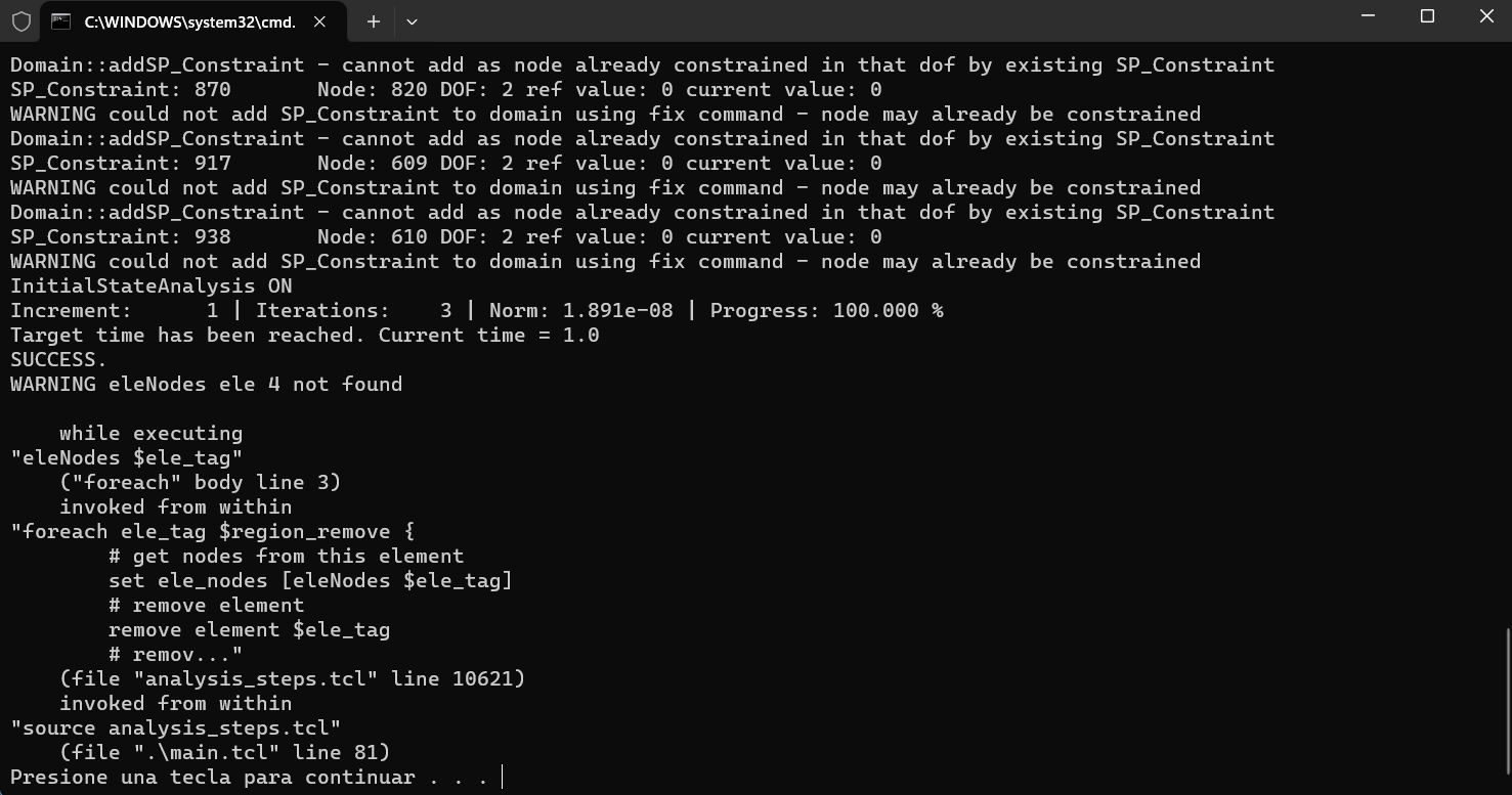

The analysis run but i'v got ow this message from the console
Re: 'NoneType' object has no attribute 'id'
Post by STKO Team » Thu Jan 25, 2024 1:51 pm
share your update file
