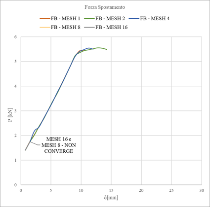

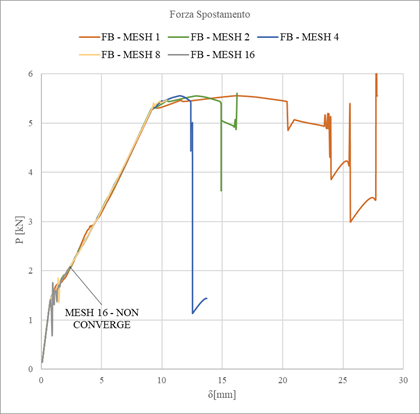

I'm trying to make comparisons between the DB and FB element using the same model and analysis while varying the mesh, excluding the regularization issue. With the same analysis settings, in this case Newton with Line Search and Norm Displacement Increment Test, FB seems to struggle more to achieve convergence, especially for the model with a higher mesh count and therefore a finer discretization. For example, with a discretization of 16 and 8 meshes in the case of FB, I do not achieve convergence in the analysis, even at the beginning of the curve (where it should still be in the elastic phase). I am attaching the model, in case there are any analysis settings that need to be modified.
To improve convergence in FB, I increased the analysis steps and changed the algorithm to Krylov-Newton, which allowed me to obtain more complete curves. However, the model with 16 meshes still fails to converge. Furthermore, due to the unrealistic oscillations in the curves, it appears that the analysis is not very robust.

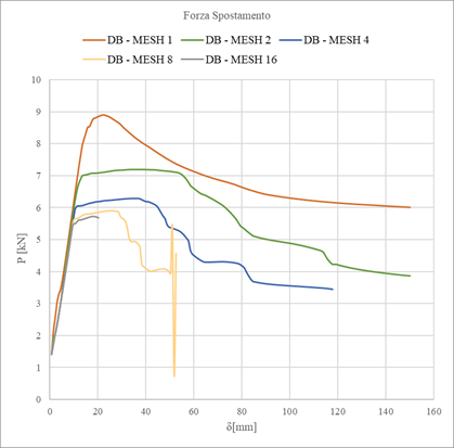

Since I've often noticed that the analysis never seems to have issues with the DB, but frequently encounters problems with the FB, and I need to improve the analysis settings as it often fails to converge, I wanted to ask if you have any suggestions for solving the problem. I'd like to have robust analyses for the FB similar to those for the DB.

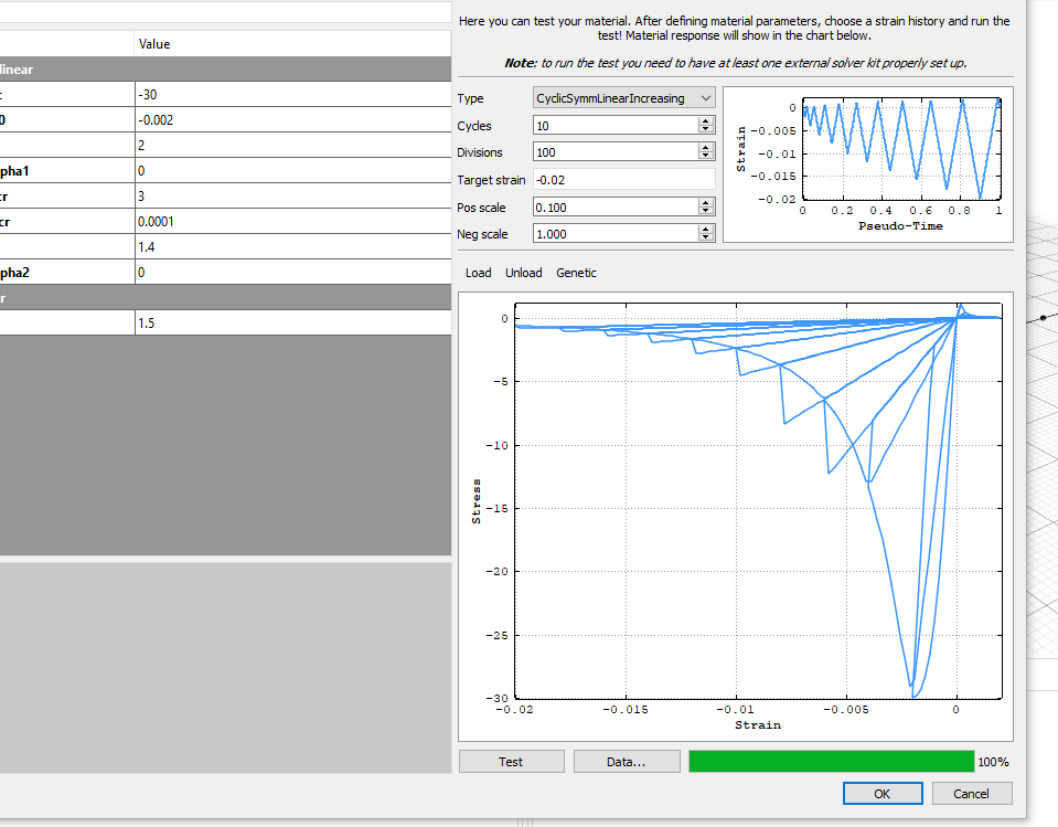

Your concrete has some strange behavior (use the material tester and check it):

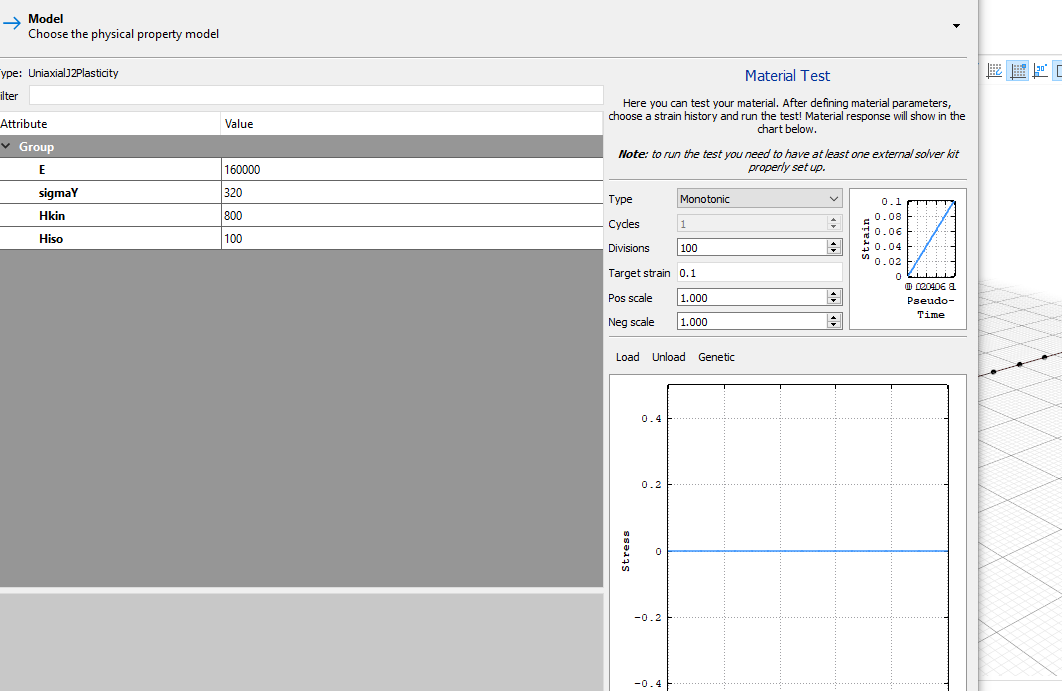

Also, your steel seems buggy, it does not provide any stress
Try something simpler like Concrete02 and Steel01 (or Steel02).
