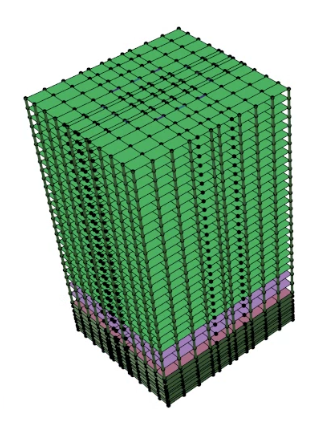

Post by kolozvari » Fri Sep 08, 2023 5:21 am
I would like to add soil springs around the basement walls and beneath the building (see screenshot below). Can you please walk me through the procedure on how to do this?

Post by STKO Team » Mon Sep 11, 2023 2:06 pm
  • Duplicate the faces of the basement walls. On these duplicates do not assign any element/physical property. In this way STKO will generate only nodes. Fix all dofs of these new faces.
  • Create a node-to-node interaction between the walls and the duplicates.
  • Assign a distributed zeroLength with appropriate materials in X-Y-Z translational DOFs
