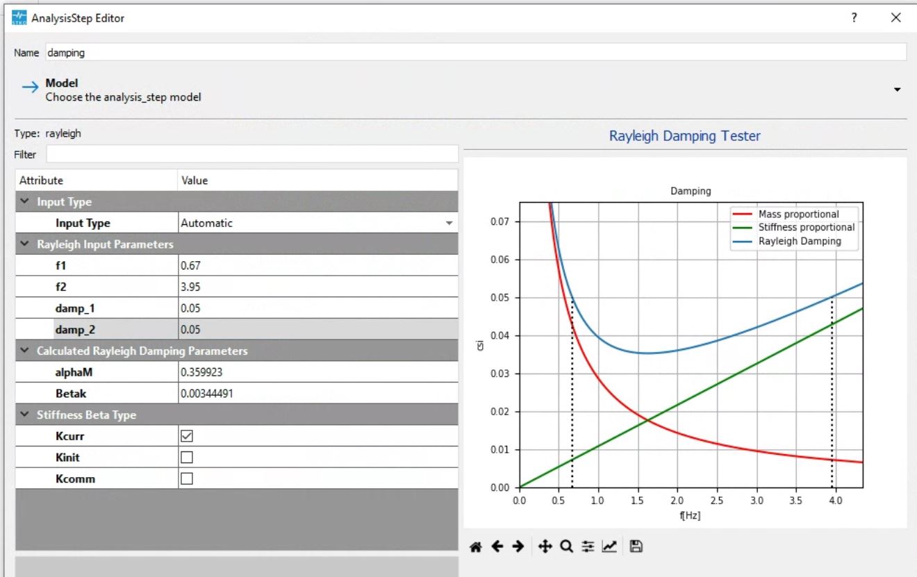

I have a couple of general questions about damping within STKO. I am currently modeling a 7 story nonductile concrete building. So far, I have been using the Rayleigh damping option provided in the analysis steps, and using the frequencies from the first and 7th modes and 5% damping in the linear model (please see attachment).
Overall, do you have any further recommendations for using Rayleigh damping for concrete buildings for linear and nonlinear models? Should I use more modes to capture the behavior? Are 5% and 2.5% reasonable damping values for linear and nonlinear concrete buildings?
Just I would use Kinit instead of Kcurr for nonlinear model (Kcurr is the tangent stiffness and may contain negative terms when you have softening)
No if you already capture a good percentage of participating mass
Yes they are reasonable.
