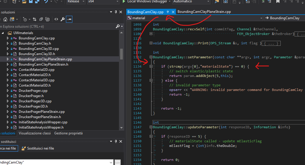

We looked into the source code.
It looks like you first need to do a gravity pseudo-static analysis to obtain vertical stress due to self-weight.
During this vertical analysis, the material response must be enforced to be elastic (using the parameter materialState,... don't ask me why they decided to use another parameter and not the usual updateMaterialStage...)
Then you can switch to plastic and go on with the transient analysis

Unfortunately, when the documentation is not sufficiently complete, the only way to understand some results/parameters of Element or Material in OpenSees is to go into the source code and search the appropriate methods.
For parameters, the method is setParameter:
Just remember that I created a selection set for the setParameter command in STKO with that surface. When you have a larger model, just make sure to create a selection set that contains all geometries (volumes in 3D or faces in 2D) whose Physical Property is the one that needs the update
