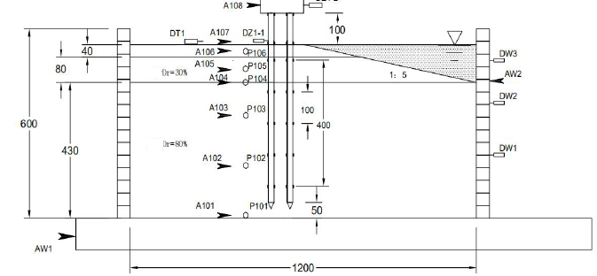

Dear STKO Team
This is one of a group of non free field trials. Due to the impact of the COVID-19 epidemic, I can't provide many information now. Later, if you need it, I will provide it
Best wishes

Is there some "interface" material between the box and the soil?

sorry. I just got back to you now. I've solved this problem. Thank you for your suggestions
