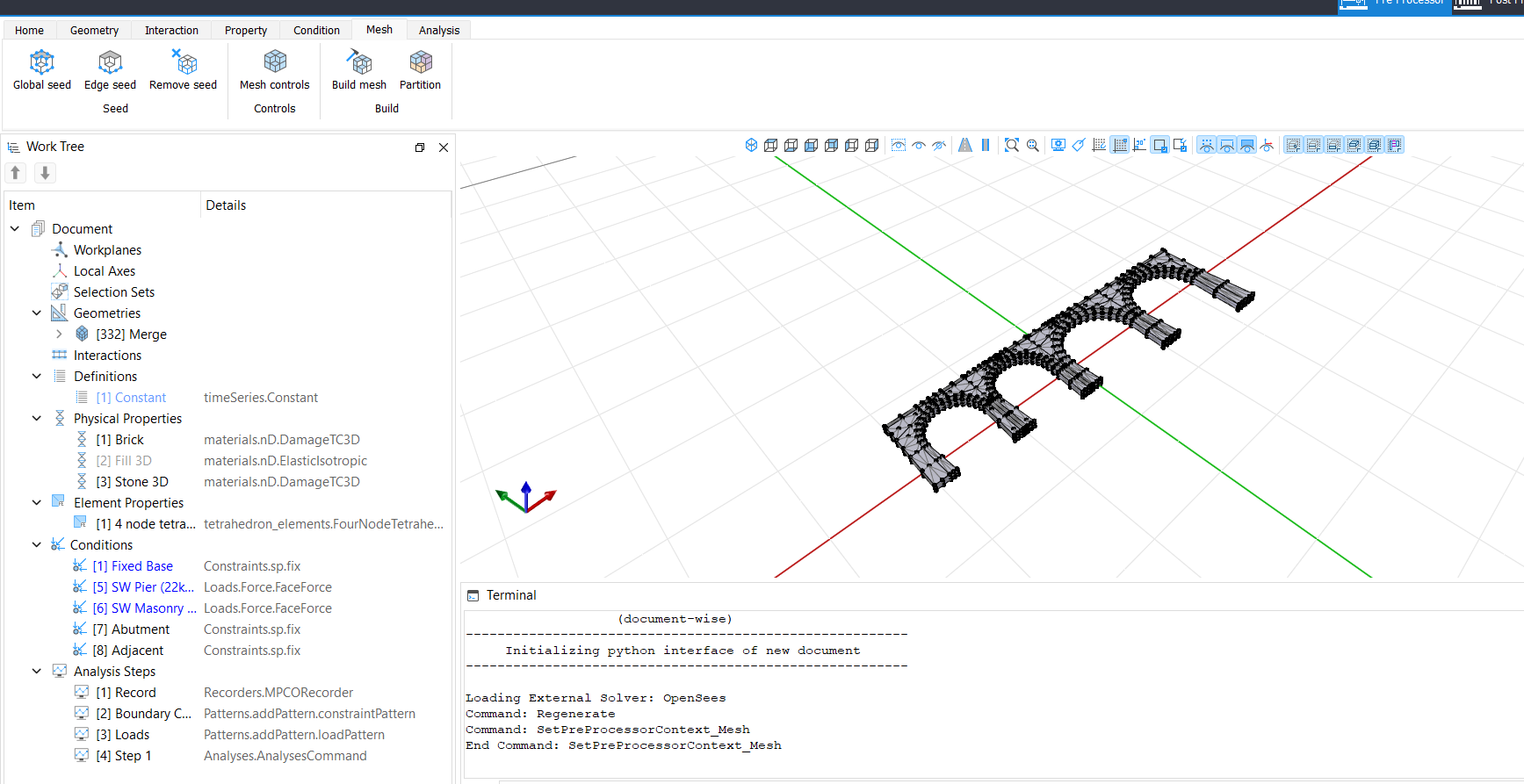

I believe the error lays on the element property and mesh size I am using. I think using a 20nodeBrick element will be more appropriate, however I am unsure on how to build a mesh compatible with this.
Thanks!
