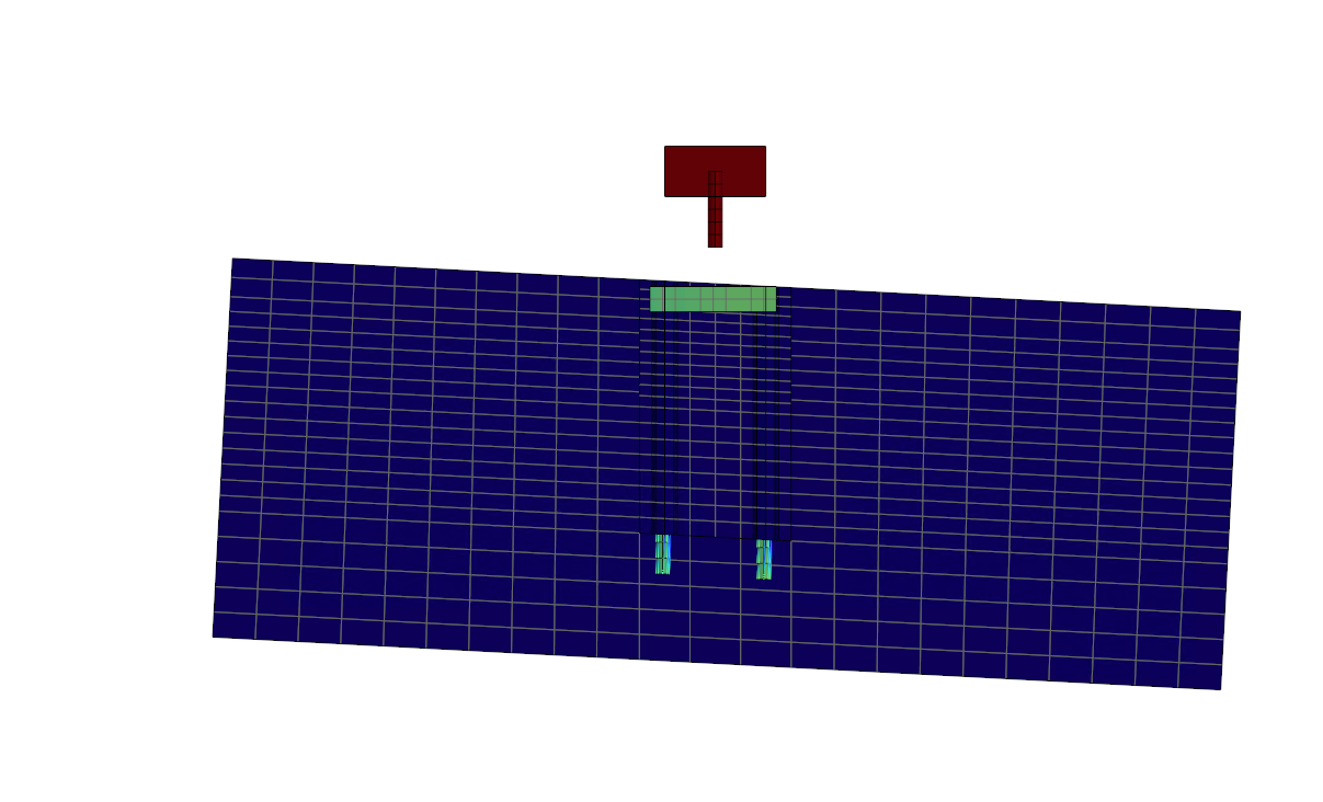

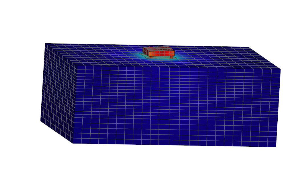

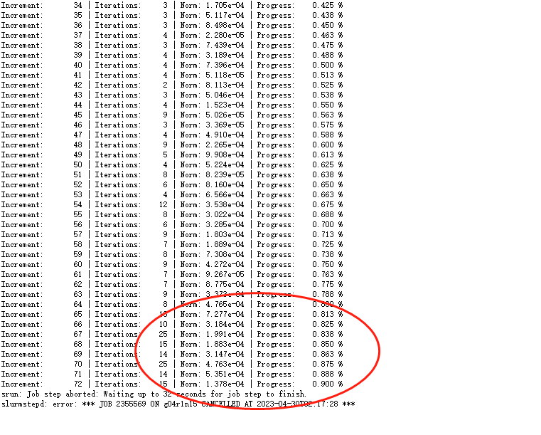

I have encountered a problem and have to ask for your help. When I use the bound contact, the model works fine. However, when I use the ASD contact, the model has a strange phenomenon of the pile falling off when the values of Kn and Kt are small, and the model does not converge when the values of Kn and Kt are large, I have tried all the previous parameters, but I still cannot reach an ideal state. Can you help me to change it? I have provided the attachment.

There are some mistakes:
- The interaction for the contact at the base of the pile MUST HAVE a master which is the BOTTOM VERTEX of the pile, not the pile itself.
- And you forgot to assign the local axes with the -Z contact direction to this interaction
