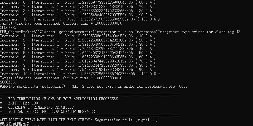

I am writing to seek your advice on an issue I have encountered while conducting a seismic analysis using OpenSees SP.
Specifically, I have defined a Lysmer-Kuhlemeyer (LK) bottom condition to implement the seismic input in my numerical model for a soil domain. However, when I attempt to run the analysis, I receive the following error message: 'WARNING ZeroLength::setDomain() - Nd1: 2 does not exist in model for ZeroLength ele: 6052.' (Please see the attached image for further information).
error openseessp.jpg (98.06 KiB) Viewed 5161 times
Interestingly, when I change the solver to OpenSeesmp, this error is eliminated. Moreover, I have also noticed that in Youngkyu's quick questions forum (viewtopic.php?f=39&t=1953), a similar LK bottom boundary is adopted, and when I run his model in OpenSees SP, the error is not raised.
Therefore, I suspect that there may be some additional errors in my model, which are causing this issue. I would be grateful if you could offer some guidance or suggestions on how to resolve this error.

OpenSeesSP has some limitations. For example, adding the LK springs on a second stage (i.e. when the model has been already partitioned) will try to add the new elements only on the first processor, and some nodes may not be there.
Have a look at the ASDAbsorbingBoundary. It should solve this issue and it's also easier to use
