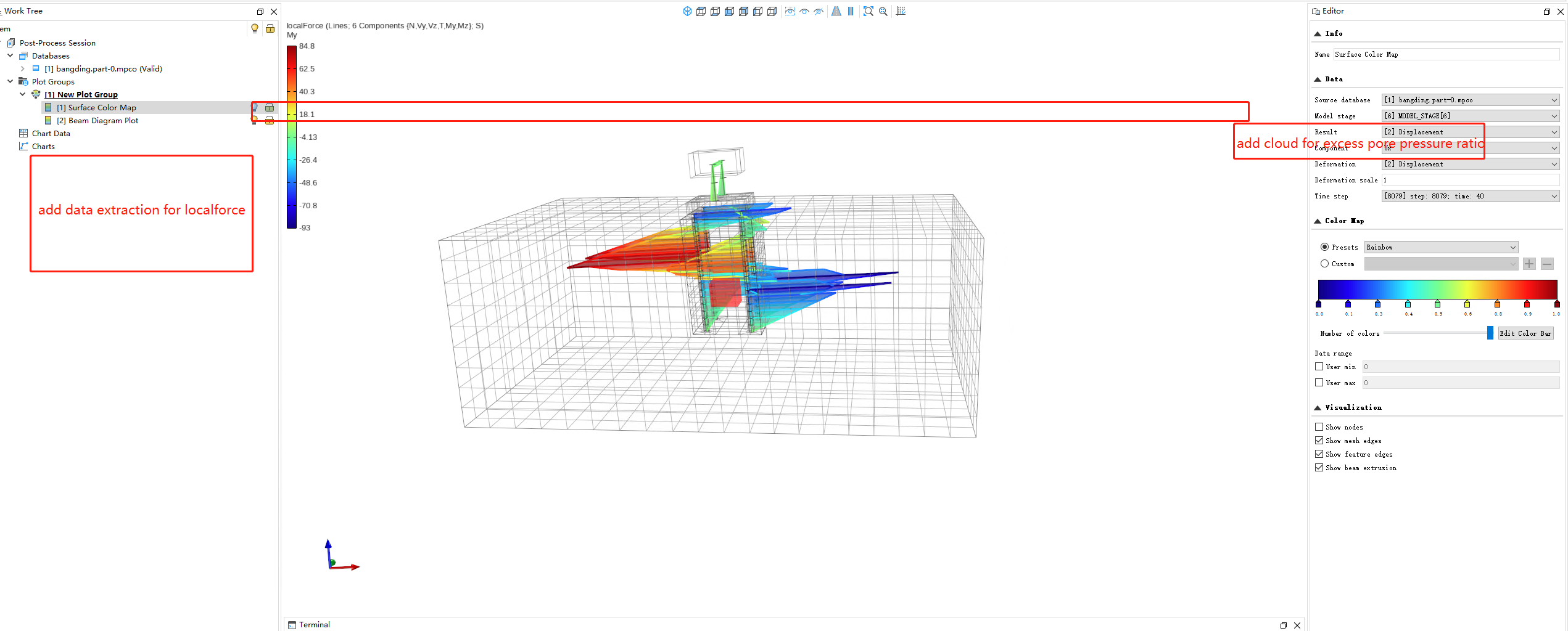

I was wondering,whether your team has plans to add some new features to the post-processing section
1. In the cloud image part, add a cloud image of excess pore pressure ratio
2. Add a function to extract localForce or GlobalForce(N,Vx,Vy,My,Mz,T) in data extraction. . Although I tried to use API , it was still not convenient.
RJ. P
Add new features
Add new features
- 20230310.png (443.66 KiB) Viewed 3814 times
