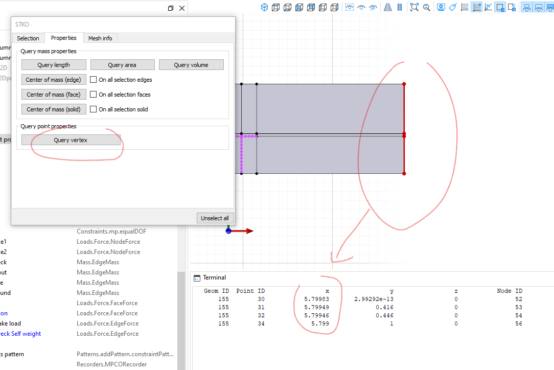

I found the error:
The reason why you cannot use the Automatic ASD Absorbing Boundary is that the right-end side of your geometry is not precise (see the X coordinate, there's an error of about 1 mm in tolerance):

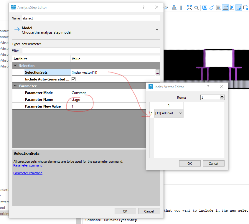

Then we switched to the manual ASD Absorbing Boundary. But I forgot to tell you that, if we use the manual ASD Absorbing Boundary, we need to use the standard SetParameter to change its "stage" parameter from 0 (static) to 1 (absorbing).
Instead, the simpler Automatic Activation works only with automatic ASD Absorbing Boundary.

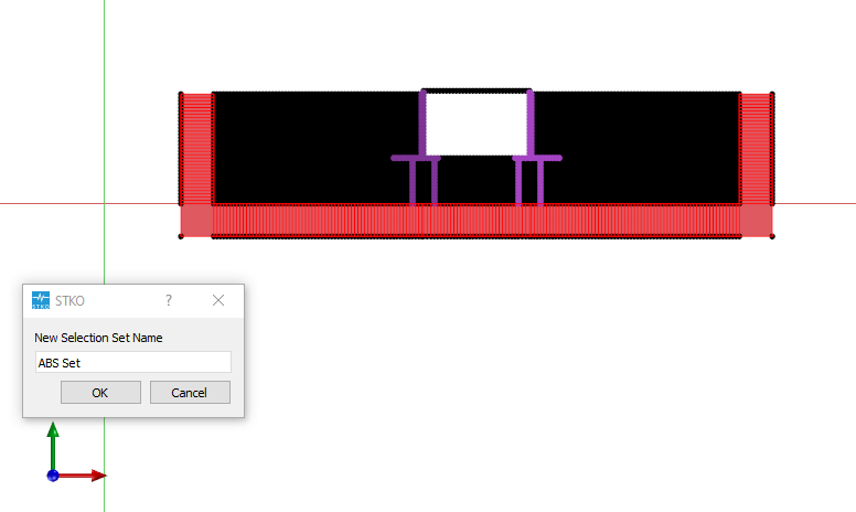

Therefore I first created a selection set with the absorbing faces: Then I used this:

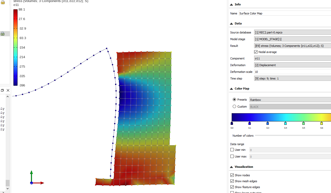

1a) The problem with the contact2D elements is still present. That is, both in the static and in the dynamic analysis the soil and the abutment wall are detaching (not in contact) thus producing negative sigma11. I can understand this for the dynamic analysis but in the static one the sigma11 should be all with the same sign. How can we solve this?

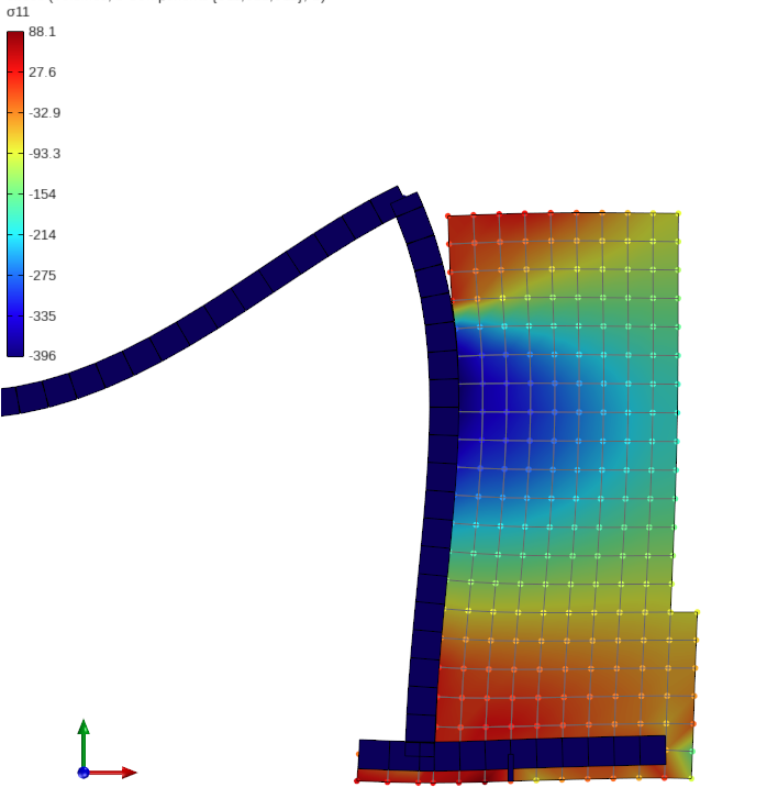

1c) In the results, the Contact2D seem to have a strange response, with unrealistic high values (please see attached image). I guess this is related to point 1b).

They are in contact. Here you see a gap due to the radius of the beam: But if you show the beam extrusion you will see that they are in contact: Of course, due to the deformation of the columns, only some portions of the column are in contact, while others (bending inwards) are not.1a) The problem with the contact2D elements is still present. That is, both in the static and in the dynamic analysis the soil and the abutment wall are detaching (not in contact) thus producing negative sigma11. I can understand this for the dynamic analysis but in the static one the sigma11 should be all with the same sign. How can we solve this?
Pay attention to the sign!, if they are in contact, you will see NEGATIVE stress (compression) in the soil

What high values? Keep in mind that they are based on Lagrange multipliers.1c) In the results, the Contact2D seems to have a strange response, with unrealistic high values (please see attached image). I guess this is related to point 1b).
