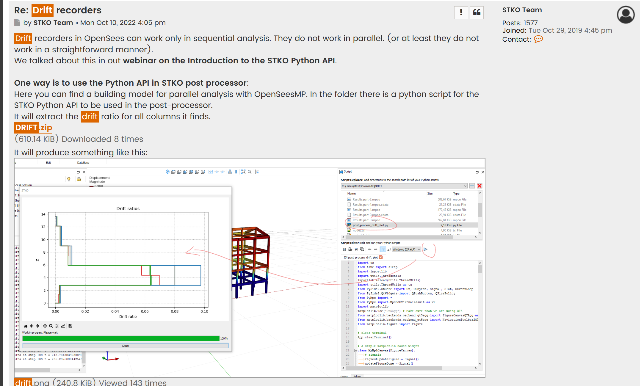

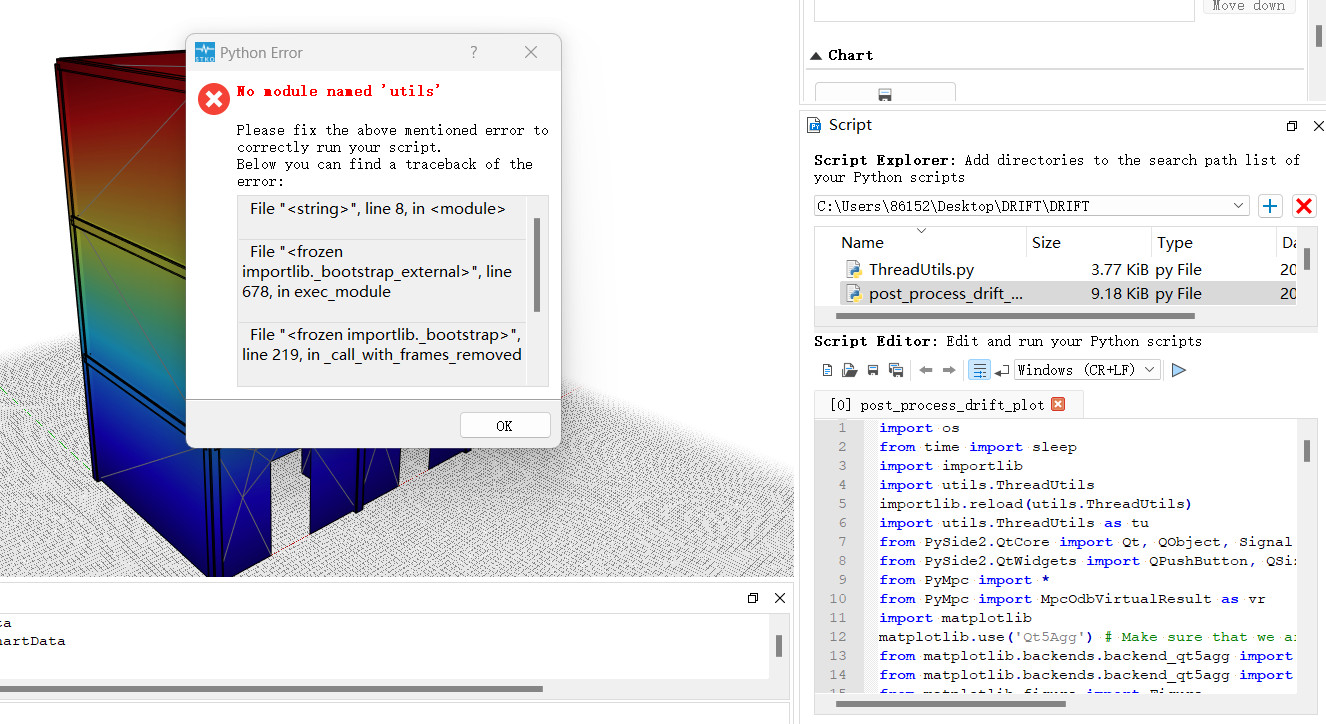

I saw a topic on the forum, STKO team gives a file to get the drift raio, this is exactly what I need! (The topic i will show in the attachment) But I used this Python API in STKO post processor, and then attachment error occurred. I have never studied python, I have no idea how to solve this problem. I conducted a search, some people said that the reason for this error is not installed utils, but the problem is not solved after installation. I would be grateful if you could give me some help.

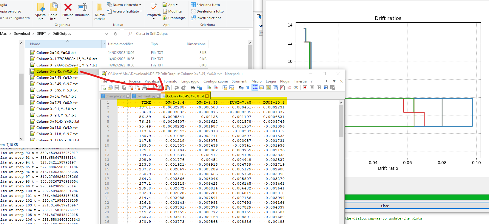

Actually,i want to ask another question,The finall picture shows the result of the last step,Is this mind right?Can I get a table showing all results?

If you know a bit of Python, you can modify the script I sent you, so that every data that we put on the Plot windows, you can write it to a text file.
Give it a try, if you can't do it, we will help you

I don 't know much about python, so I ask for help from my partner, but he does not understand the relevant content of the building, so we fail. So If you can help me, I will be grateful.

Try this:
DRIFT.zip
(5.07 KiB) Downloaded 225 times
It will create a folder with 1 file for each column. In each file you have 1 line for each time step.
In each line you have the time + the drifts at each floor
