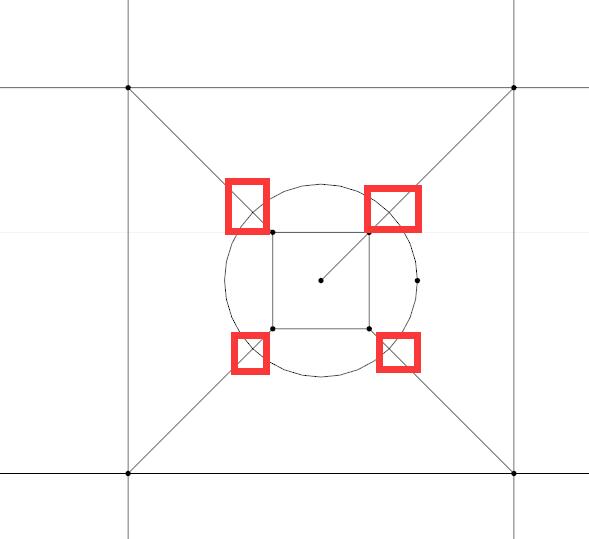

Also, going back to the question in the title, the line connecting the small square to the pile bearing will intersect with the circle of the pile, how should I do it so that the point falls precisely at the intersection of the line and the circle when using the point drawing operation? When I use the draw point operation, the intersection point is not automatically selected. (I've uploaded the diagram in the attachment)

The square and all other construction lines are done in order to have a structured hexahedron mesh.
To have this kind of mesh, you need to have volumes that are bounding exactly by 6 faces (like a parallelepiped).
Therefore, they can be extruded from faces that are bounded exactly by 4 edges (and 4 corner vertices).
That's why a I need all those construction lines.
The only thing you need to do, is to draw you circle so that the second point (when you click for the second time during the circle command) is at a direction = 45° with respect to the global X axis.
In this way the circle point will coincide with one of those 45°-inclined lines.
Once you're done with the lines, you can use the Planar command to create planar faces from a grid of lines

As you said, the squares and other building lines are for creating structured hexahedral meshes later. So there is no limit to the size of this square right? It only needs to be on the inside of the circle?
I noticed that only when the second point of the circle falls on the 45° diagonal, the intersection can be automatically selected when using the Point operation at the intersection of the drawn circle and the 45° diagonal.

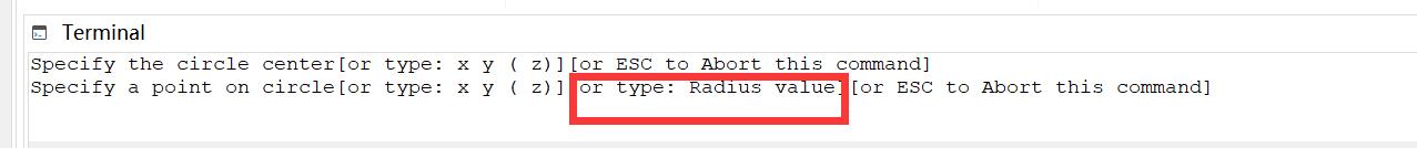

But this then brings another problem, if I use the mouse to land the second point on the diagonal line (for example on the midpoint of the diagonal line), this will be easy. But usually when we draw a circle, we want to specify the diameter of the circle exactly, so how do I do it so that the second point of the circle remains at 45° to the global X axis while still entering the radius value I want for the circle?
I noticed that when drawing a circle the command box prompts for the degree, but when I enter 45° it prompts for invalid command input.

You're right, if you type the radius, STKO will automatically create a point in the X direction of the current workplane.

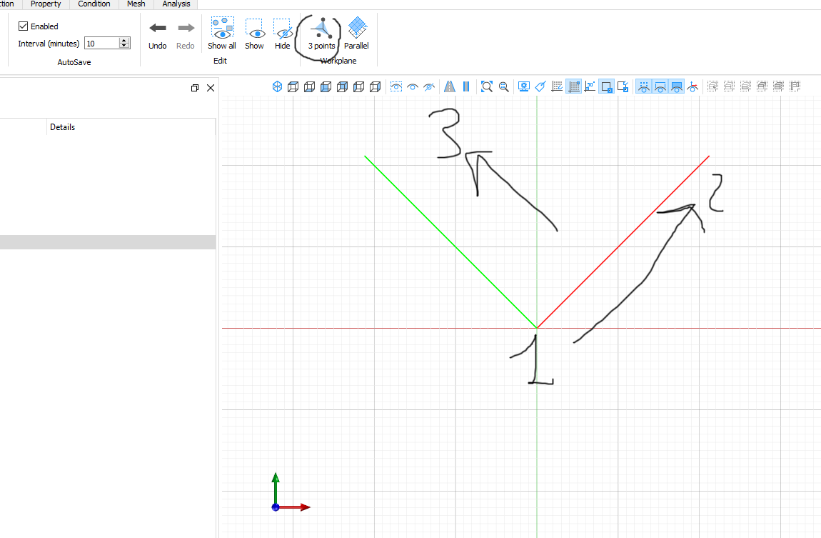

You can either rotate the circle after you create it (using the Rotate command), or you can first create a workplane in an inclined (45°) direction, then you draw there.
