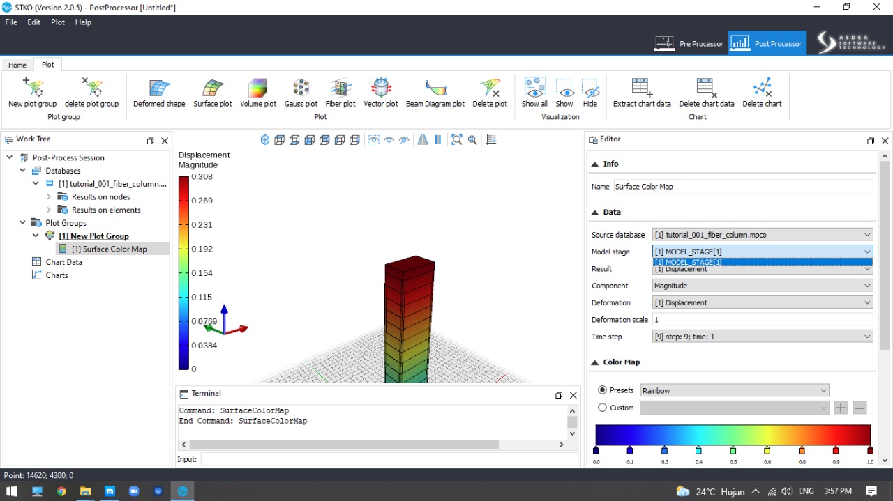

Hi, I've just learn about STKO and I try to modeling RC fiber like in this asdea youtube tutorial :
https://www.youtube.com/watch?v=vPB9ZwT ... 7qTOJL94rv
I download and use the file used from that webinar https://asdeasoft.net/?webinar#02
But when I move to post-processing, I cant find model stage 2 from the databse. Any suggestion to help me bring up the model stage 2?

Unfortunately the webinar is very old and we forgot to update the files with the new version of STKO/OpenSees.
Attached the modified working file.

thank you very much, now I can find modal stage 2 and I can see the stress-strain curve :D
