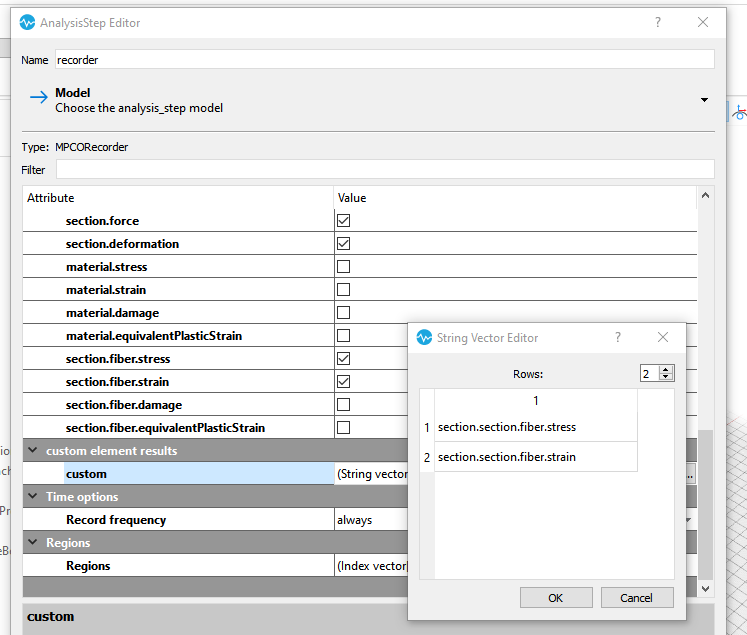

Dear STKO,
The post processor does not show the fiber color map results. I tried to rebuild the model many times but can't get any improvement.
I attached the file, any help would be much appreciated.

Recently the OpenSees' developers changed the way the section aggregator handles the results (unfortunately).
Before you could as for section.fiber.stress.
Now, since the fiber section is a section inside another section (aggregator), they changed it to:
section.section.fiber.stress
To solve this you need to: here is what I changed in the recorder:

This was very helpful! Thank you.
