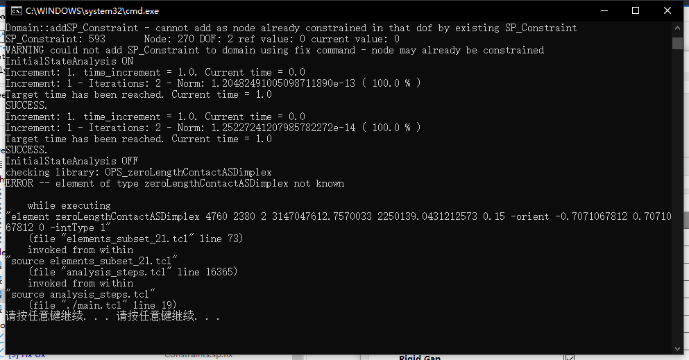

When I try to use the new "zerolengthcontactASDimplex" element, a small error happened. What should I do to solve this problem?

This new element has been added recently to the official OpenSees repository, but the official OpenSees executable has not been recompiled yet.
However, this element is already available in the OpenSees Solvers available from prof. Tarque's webpage. Download the latest version and this error should be solved.

The problem has been solved, thanks for your quick help!
