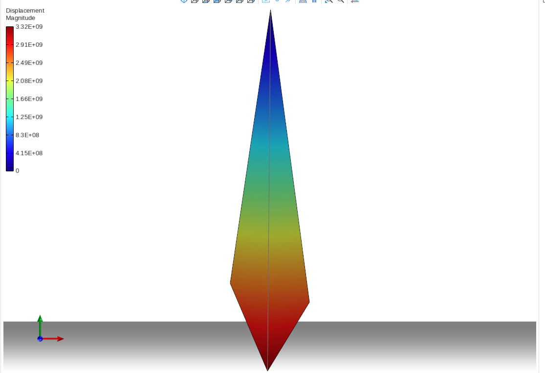

The beam appears as in the photo. It is very strange.

You have very high displacements, so the deformed shape of the beam is distorted. Did you check at different time steps? and the load you are applying or the duration of your analysis?

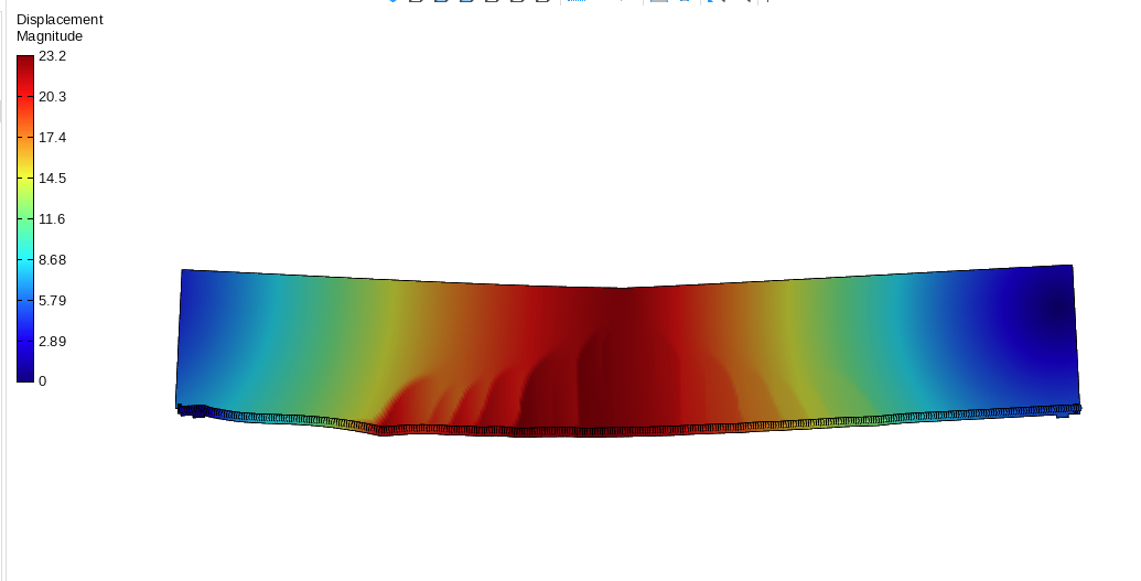

Post by marafini.f » Fri Oct 22, 2021 10:18 am
this is what I see when I run your model as it is
I found some mistakes in your model. You had applied the pin condition to both supports, and also did not apply the equalDOF to the left side interaction infact as you can see from the picture it was breaking on one side.
Here is the corrected file
H1500_FRC75.zip
(736.48 KiB) Downloaded 204 times
