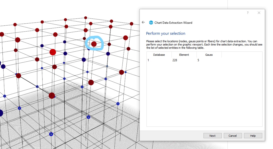

How to extract the results from gauss points at end of a particular element intersecting at a node. Like In the given figure, . When I select the gauss point only gauss point of element 228 is selected. There are four elements joining at this node. So how can I select the gauss point of any other element at that particular node.

Probably you can select only the gauss point with the largest value, because (by default) the gauss plot scales the size of the gauss particles according to their value.
Try to change the particle scale factor to Constant (on the bottom of the Editor of the Gauss plot).
Then try to select it again. A window should pop-up with all the overlapping gauss points
