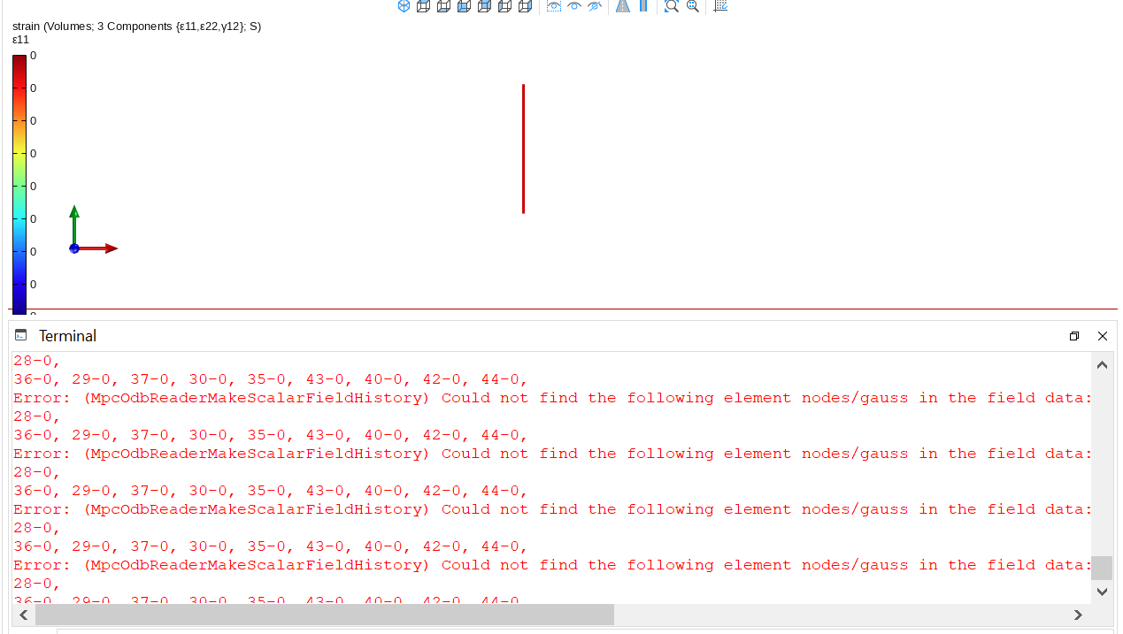

I have tried to do what you suggest to extract the bending moments on the wall (they are DispBeamColumn). I have set the view to see only the retaining wall, then I have extracted the chart data, but I have got an error (please see attached figure).
Please note that when I open the Gauss point plot, I can only select E4 (strain) or E5 (stresses), while the bending moments are only visible in the Beam Diagram plot.
Could you please help me to solve also this problem?
Thank you very much

this is because the localForce output is not a result on gauss points (it is on the element's end-nodes).
If you need beam forces along the element, in each gauss point, you need the section.force output.
But to do so, you first need to use either a forceBeamColumn or a dispBeamColumn, i.e. those elements where you can specify an integration rule.
