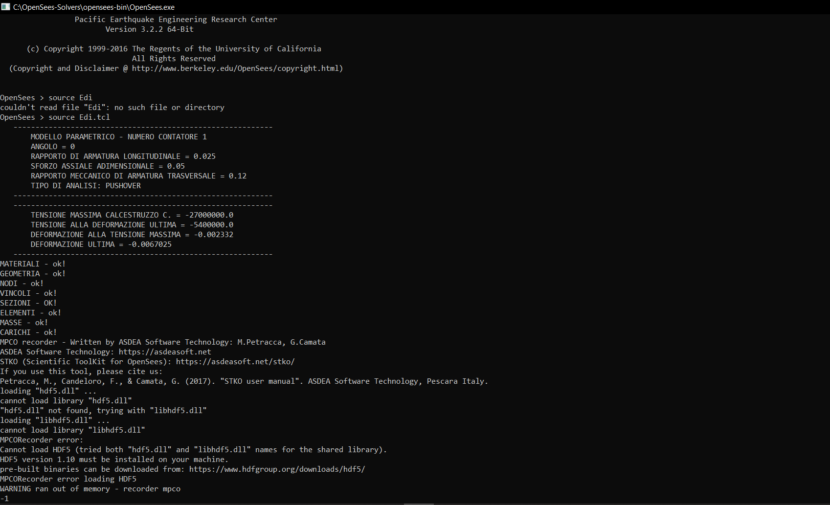

I would like to visualize my tcl model in Stko. I downloaded the program and the OpenSees Solver, then I used the mpco recorder but OpenSees reported this error (I am attacching the immage).
How could I resolve the problem?

Dear Mattia,
Another user encountered a similar error previously. Try following the solutions written here: viewtopic.php?f=40&t=1698&p=2287&hilit=library#p2287
Let us know if this works, or if you continue to have problems
