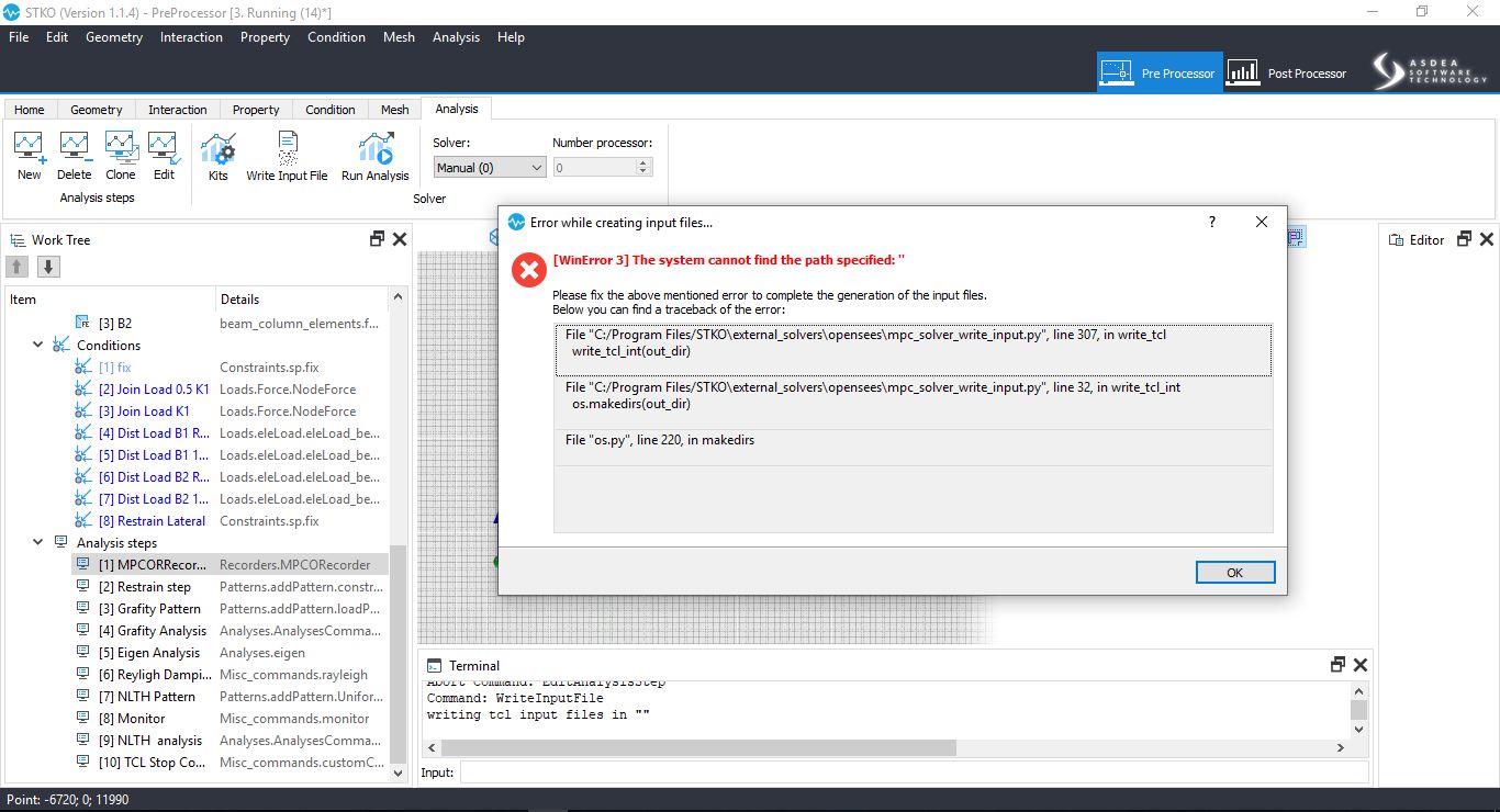

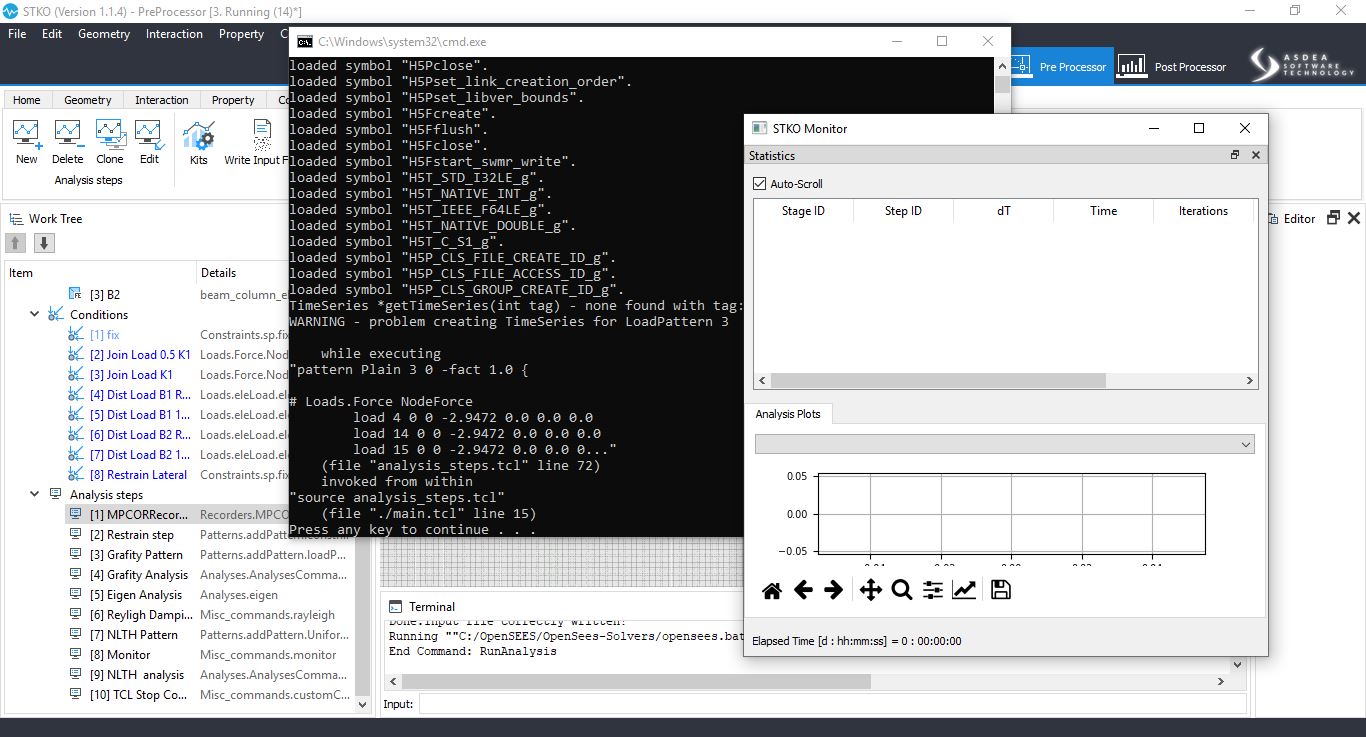

A respectful salutation, ask permission, Why I could not process my analysis? in a write input file or run analysis.
Note:

TimeSeries *getTimeSeries(int tag) - none found with tag: 0
WARNING - problem creating TimeSeries for LoadPattern 3
while executing
"pattern Plain 3 0 -fact 1.0 {
# Loads.Force NodeForce
load 4 0 0 -2.9472 0.0 0.0 0.0
load 14 0 0 -2.9472 0.0 0.0 0.0
load 15 0 0 -2.9472 0.0 0.0 0..."
(file "analysis_steps.tcl" line 72)
invoked from within
"source analysis_steps.tcl"
(file "./main.tcl" line 15)

Dear user,
that error means that some of your load patterns do not have a timeSeries.
