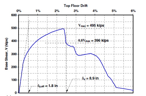

I am trying to study a specific model assumption
However , the results are hugely different in values
and curve pattern.
Maybe there something in nonlinear components or
in the load pattern . I am not sure .
the reference :
https://ascelibrary.org/doi/pdf/10.1061 ... YZYxZdDgc8
I am attaching the wrong and right curve due to the reference
PushOver Curve.jpg (55.1 KiB) Viewed 1530 times
PushOver Curve2.jpg (54.34 KiB) Viewed 1530 times

It seems you have problem of convergence and your model is softer. Check convergence and the stiffness of the model, without additional details we can't help you more. Could you send us the stko file?
