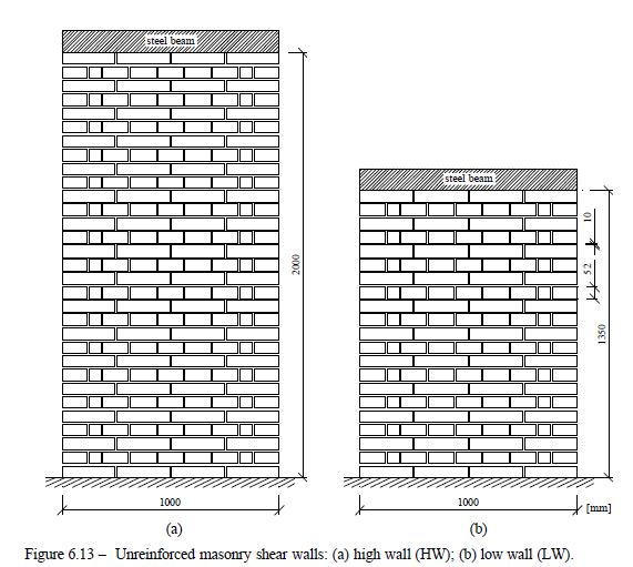

Dear Sir/Madam
I would like to model the behavior of the masonry walls attached here as a beam-column element with moment and shear hinges (phenomenological models)in STKO. Boundary conditions: Top-> guided roller, bottom-> fixed. Is that assumption correct? If yes, actually, the wall would undergo double-curvature behavior in the first case i.e., slender wall, in such a case, should we have to assign moment hinges at both top and bottom? or only at the bottom? Because, from the basics of structural analysis, this beam-column would be subjected to the same bending moments at top and bottom (lateral shear x Height/2), so both would reach cracking moments simultaneously. Would it make the model unstable if we have assigned moment hinges at the top and bottom as static-indeterminacy of the beam-column is 1? Thank you

It depends on how the experimental set-up has been made. Make sure to model the BC exactly as they are in the experimental set-up. Pay attention to how the vertical displacement is handled. In some experiments, they first apply a vertical load (the wall displace of a certain amount in the Z direction), then they fix the vertical displacement at the current position.Boundary conditions: Top-> guided roller, bottom-> fixed. Is that assumption correct?
Yes, because the rotation is fixed at both ends, so both of them will experience a flexural deformation (it is not a cantilever)should we have to assign moment hinges at both top and bottom?

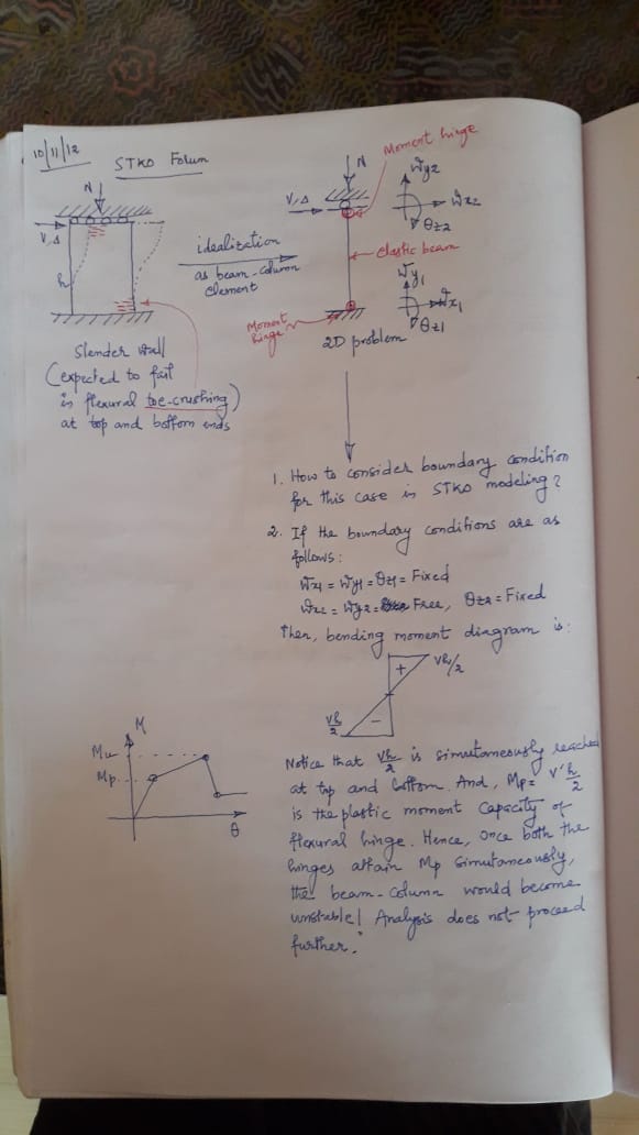

I don't understand this one... Why should it be statically-undetermined? It won't be, at least not until one of the 2 hinges completely fails and gives a zero stress.Would it make the model unstable if we have assigned moment hinges at the top and bottom as static-indeterminacy of the beam-column is 1?

"I don't understand this one... Why should it be statically-undetermined? It won't be, at least not until one of the 2 hinges completely fails and gives a zero stress"- I tried to explain it to you by drawing a sketch of the wall idealization. Kindly find the attached figure here.

I understand that once the hinges go into softening regime, the analysis becomes unstable, but not yet undetermined. For sure you need to do something to overcome convergence issues.
First you should use a Displacement-Control integrator, as the LoadControl cannot pass the peak.
Here you can find 2 examples (change material parameters as per your experimental test).
- The first one uses the Lumped-Plasticity with Finite-Length-Hinges (i.e. Fiber section at the beam ends, and elastic section in the middle). The fiber section gived a moment-curvature response that is spread along the plastic-hinge length (in this example 150 mm)
- The second one uses the Lumped-Plasticity with Zero-Length-Hinges (i.e. Phenomenological uniaxial models, and elastic section in the middle). The Moment-Rotation is calculated trying to replicate the Moment-Curvature (integrated over the plastic hinge length) of the Fiber section used in the other file
