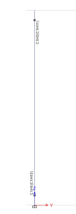

I want to set the plastic hinge at the location of 0.95 and 0.05 of the beam(The location both ends of the beam equals 0 to 1.), because the failure usually happens at that location not at both ends of the beam. Then, I analyze it through pushover analysis and time history analysis.
After I finish my analysis, the result of pushover analysis is almost the same as the one in ETABS(I set plastic hinge at the same location in ETABS).
But when I try to analyze it through time history analysis, the result is not convergence.
The model seems to be worked only in pushover analysis.
The following is my model(pushover analysis and time history analysis). How could I solve this problem?
Any advice and helps that you provide are highly appreciated.
