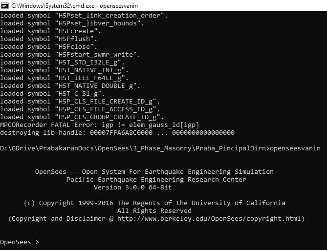

Dear Sir
I kindly request you to suggest a solution to fix the error in the attached file. The error showed up when I run TCL code of my masonry model (It is a custom made and not created in STKO). Actually, I am trying to visualize the model in STKO post-processor. I have already placed hdf5.dll, slib.dll and zlib.dll in the OpenSees.exe folder.Thank you
Error while running TCL code with MPCO recorder

Dear User,
this kind of error is triggered by the MPCO Recorder when using some elements that do not implement correctly the output for fibers. Those elements are elasticForceBeamColumn, zeroLengthSection and trussSection, are you using one of them?

Dear Sir
Thanks for your reply. Yes I was using one of that element, I will change them with other elements
