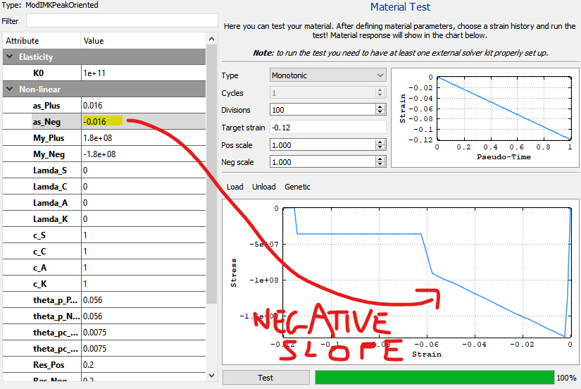

I write you in order to ask you why it is possible that a moment curvature diagram of a lumped plasticity model with zero
lenght using the command ModIMKPeakOriented shows a decreasing stretch after yielding even when I defined it as an
incresing after yielding for the beams as you can see in the attached photos in which the first is the input and the second
the output after several steps.

I think that the drawback could be in the definition of the analysis, though I am not sure where. Moreover,
it results some weird since the diagram has the same behaviour as I defined for the colummns. Hence, I look forward to you can help me.

The reason for your wrong response with negative rotations, is that you defined the hardening ratio for the negative part, as a negative value. But the hardening ratio is a ratio (and defines a slope) so if you put a negative value, you will have a negative slope (softening) rather then hardening:

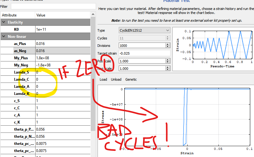

One more thing, all "Lambda" values should not be 0 (even if they say 0 is the default for no degradation, they meant 1, there is an error in the opensees doc...):

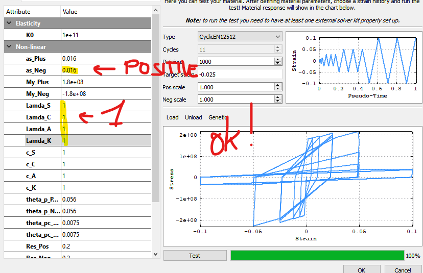

Finally this is the correct form:
