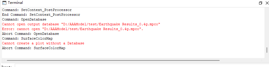

Dear STKO Team:
My model utilizes the ASDConcrete3D material, I upgraded my OpenSees-Solver veision from 3.4.0 to 3.7.2 (both are compiled versions by Prof. Tarque).

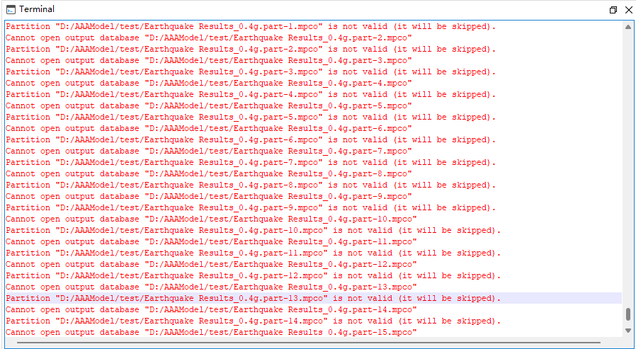

However, after completing the calculation using version 3.7.2, when I try to open the post-processing file, I receive a prompt:
Cannot open output database "PATH/Earthquake Results.part-*.mpco"
Partition "PATH/Earthquake Results.part-*.mpco" is not valid (it will be skipped).Cannot open output database
I am unable to load my MPCO file during the calculation process. And I can't open my post-processing file at all!
When I roll back to version 3.4.0, I could load MPCO files during the calculation process, but in that case I couldn't use ASDConcrete3D material for the calculation.
Do you have any solutions?

Sometimes you run an analysis with let's say 10 processors.
The you re-run it with less, let's say 8, processors.
When you try to open it, STKO will find also the previous 9th and 10th, which belong to a previous model.
Make sure this is not the case for you

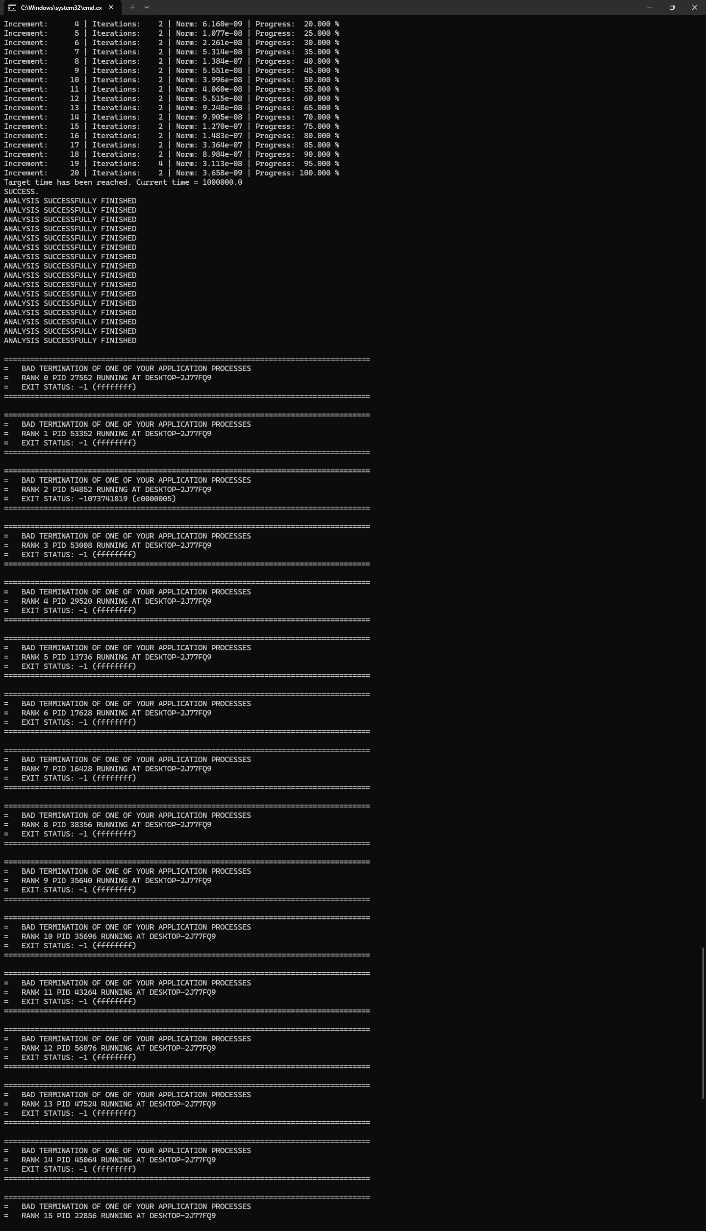

Here are the problems I encountered.
I've also attached my model.

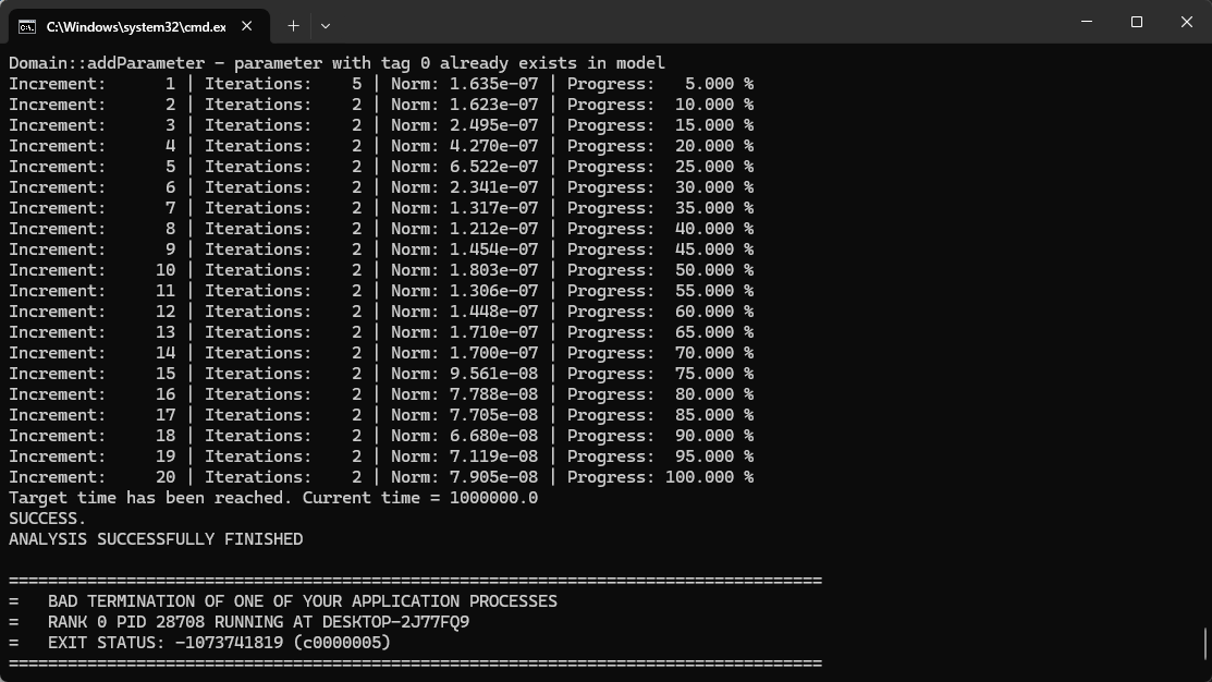

UPDATE INFO:
Additionally, I created a model with partition 1, but the results still cannot be displayed.

Regarding you errors:
I still your errors that the end regarding the BAD TERMINATION. And it seems to be a bug in the InitialAnalysisStage on/off commands source code in OpenSees.
I tried to comment those 2 commands and the error disappears.
Anyways, in my case I can see the output with both the InitialAnalysisStage command commented and not commented.
Can you try to comment it out, just to understand if it's the bad termination that corrupts your files?
Commenting out InitialAnalysisStage on/off really solved the problem; it ran without errors, and the .mpco file could be opened and viewed normally. But how did this problem occur? Will this issue persist when using the InitialAnalysisStage on/off command in OpenSees-Solver veision 3.7.2?

I think my wording might have been a bit off. What I meant was: I wanted to check if there was a problem with OpenSeesMP, so I removed the partitioning and switched to OpenSees for the calculation. For the same model, the unpartitioned UMFPACK+RCM (with OpenSees) failed to converge in the first analysis step; however, the partitioned MUMPS+Parallel RCM (with OpenSeesMP) converged.
So maybe it's due to some instability (like unconstrained DOFs), and in those cases, some solvers might be more tolerant than others.
It has been fixed last month, so it will disappear on the next OpenSees version. Furthermore it seems they detected it with SSPBrick elements. Maybe it doesn't happen with other elements
