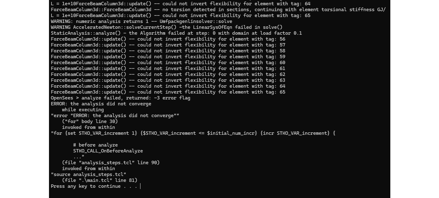

i am running the cyclic analysis of masonry wall and facing this error.

There are some basic errors in your model.
Some of them are:
  • The 2D plane stress element has a 0 thickness!
  • The beam is 3D but the wall is 2D. You cannot mix them
