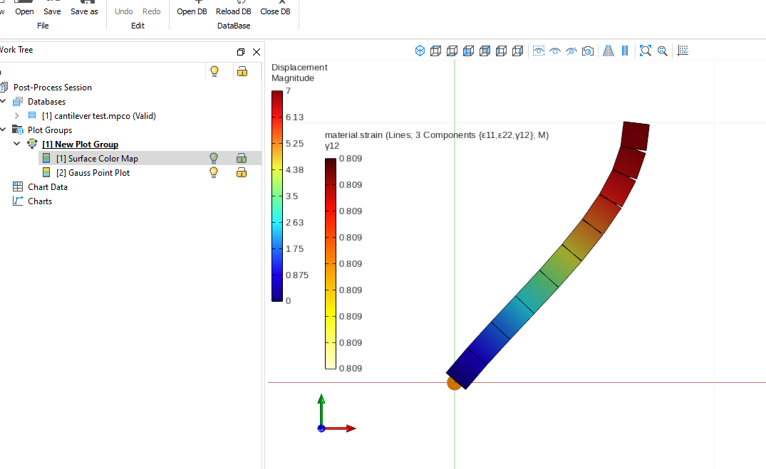

Your simple (cantilever) does enter the nonlinear range.
You just need to increase the applied load, because based on your material parameters you are not yet in a strongly nonlinear regime.
I refined your mesh to better illustrate the results. As you can see, part of the lateral displacement comes from the elastic deformability of the beam, while another part results from the nonlinear rotation of the hinge.

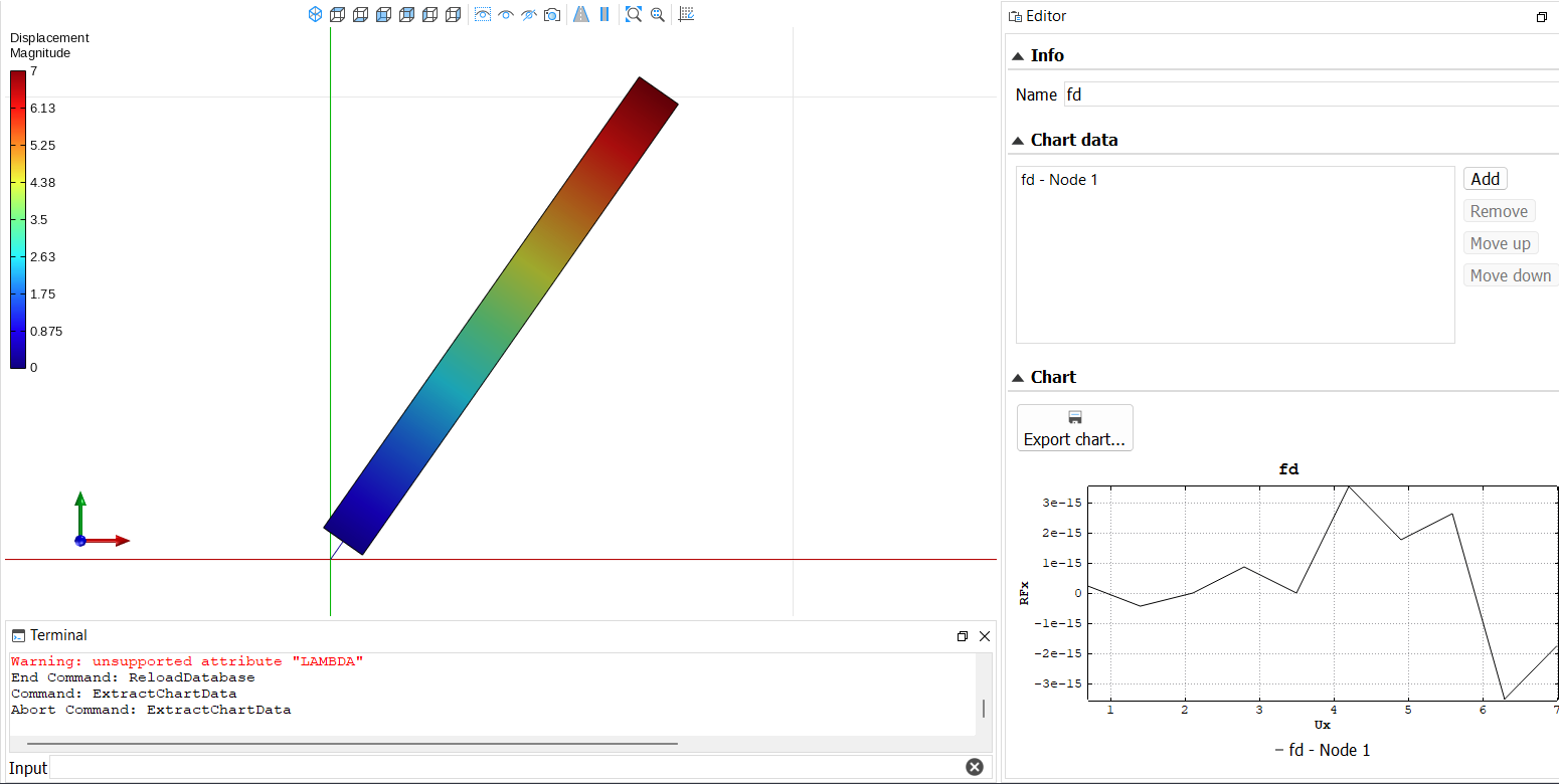

Another question, I am worried there is something wrong with the way I apply my force or my analysis steps, because in the post-processor, on the top node, I get the graph below.
I would also like to see element results to verify the nonlinear spring response by plotting the force-displacement response and checking my yield stress. Any help in that area would be greatly appreciated.
