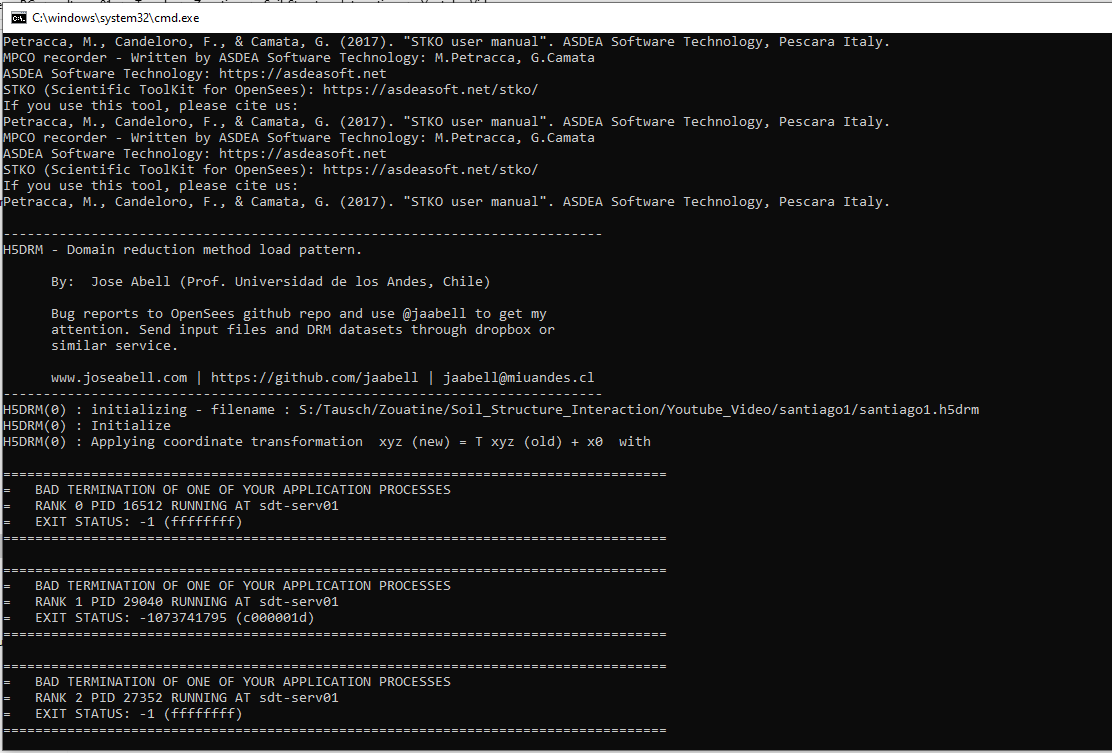

I would like to kindly request your help regarding the following issue:
I attempted to replicate the model presented by Professor José Antonio Abell, as described on the following page:
https://opensees.github.io/OpenSeesDocu ... H5DRM.html
In my case, I also used the ground motions from the Santiago case (I was not able to attach the file here since it is approximately 1 GB). The mesh size is 1 m, as recommended on the webpage. However, when I run the analysis, I encounter the issue showed in the picture.
here is my model :
Thank you,
Domain Reduction Method Error " BAD TERMINATION"
- Error.PNG (54.4 KiB) Viewed 5697 times
Re: Domain Reduction Method Error " BAD TERMINATION"
Hello.
Which version of OpenSees are you using that generates this error? Are you compiling your own version?
I'd suggest temporarily trying out one from before August 2024 to see if the error is still there.
JAA
JAA

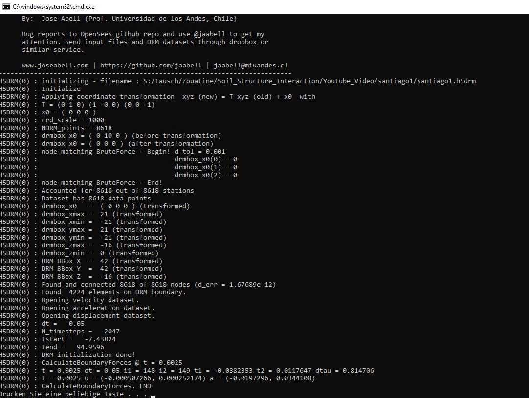

However, I got the idea to try it on a single processor, so no model divisions (using the 3.7.0 and 3.7.2 OpenSees versions available on the ResearchGate website). I changed the AnalysesCommand from parallel to a single processor + remesh. I noticed that the error has changed to the following:
So now a different error appears, and the postprocessing file is missing. I could be wrong, but this made me question whether the GM dataset is correct for parallel analysis (since i am the santiago dataset from you website). I would appreciate it if you could share the compiled OpenSees (the one with OpenSeesmp.bat)versions that you used and give me an insight about my issue.
Hi, I'm going to need to update the dataset and the tutorial it seems. Recent changes might have broken this example. My time frame for this is this semester. I'm currently working with two PhD students on verifying the full ShakerMaker+H5DRM+OpenSees stack to work out all the issues. By the end of the year we should have some new on this regard.
On the other hand, I'm a Linux user, so I can't share an executable with you.
