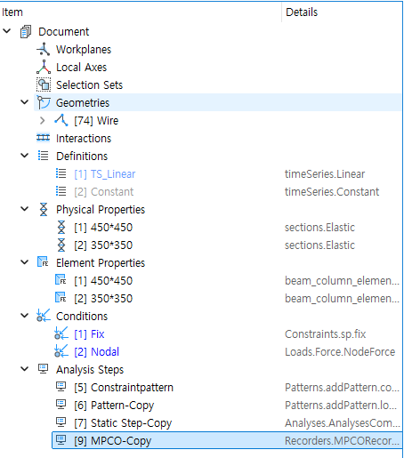

Hello everyone,
I am building a 3D frame + slab model in STKO and trying to run a static analysis.
As suggested by the STKO team, I have already:
Used MakeWire to join the lines,
Added the Fix condition into a constraintPattern with a Constant TimeSeries,
Defined the nodal load in a loadPattern with a Linear TimeSeries,
Disabled loadConst and used wipeAnalysis = ON.
However, when I run the static step, I still get the following error:
WARNING BandGenLinLapackSolver::solve() - factorization failed, matrix singular U(i,i) = 0, i=0
WARNING: CTestNormDispIncr::test() - failed to converge
StaticAnalysis::analyze() - the Algorithm failed at step: 0 with domain at load factor 0.1
My current setup is:
Physical + Element Properties: elasticBeamColumn (with mass per length)
Fix condition: added via constraintPattern with Constant TS, ID=1 (Fix)
Load condition: added via loadPattern with Linear TS, ID=2 (Nodal Force)
Static Step: LoadControl (λ=1), Fixed step, numIncr=1
Mesh built successfully (after MakeWire)
Question:
Could this error still be happening because my model is essentially planar, leaving some out-of-plane DOFs (e.g., Uy, Ry) unconstrained?
If so, do I need to apply an SPC condition to all nodes to restrain those DOFs?
Any advice or similar experiences would be greatly appreciated.

Re: OpenSees Static Analysis: BandGenLinLapackSolver::solve() – matrix singular U(i,i) = 0 error
Both your models in the attached zip files still contain the same errors (separated geometries, and constraint not in constraint pattern)
