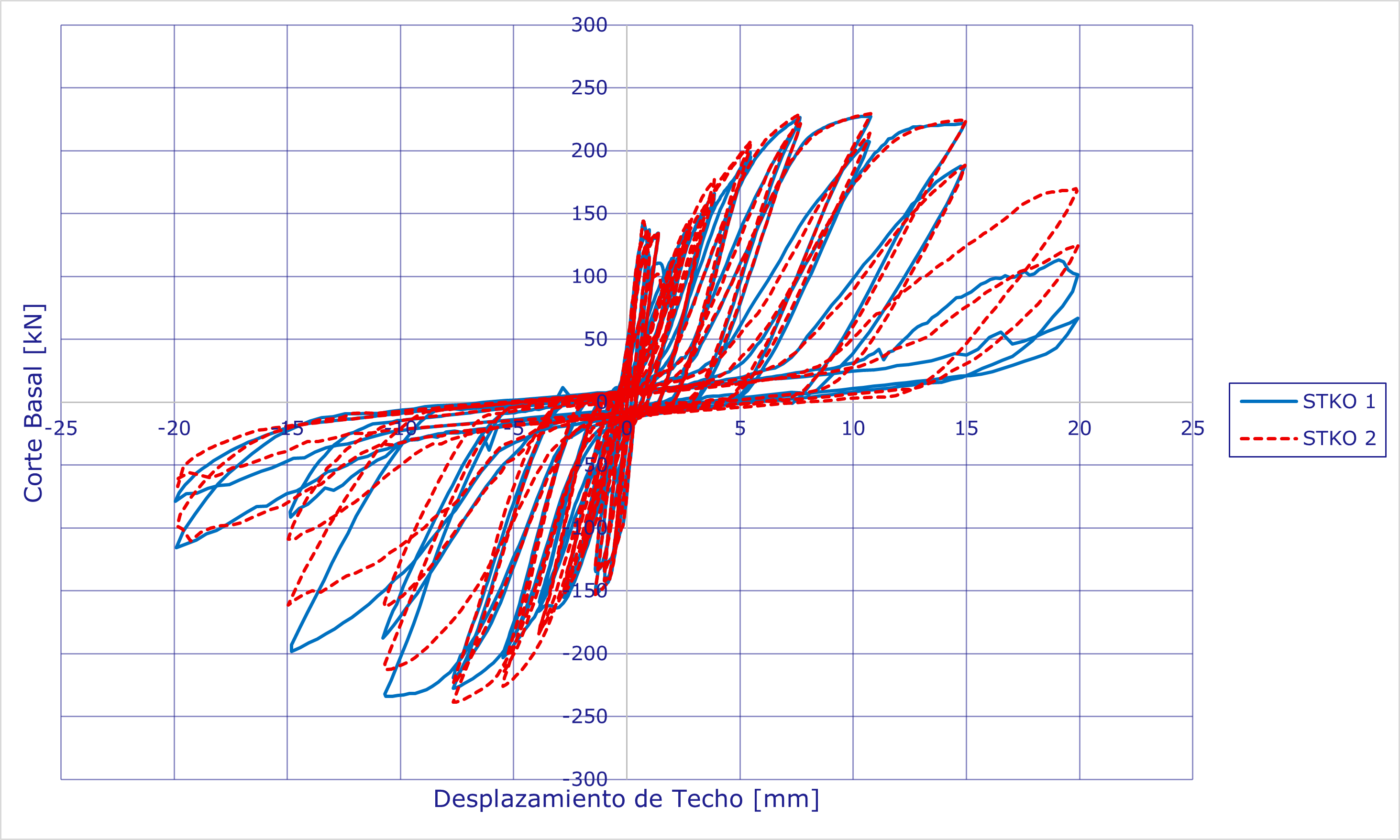

1) There is no difference between the models, I just run the model a first time, next I saved the roof displacement vs basal shear hysteresis, and after that I run the model a second time. I attach a graph with two plots of the same model; as you can see, the results are not exactly the same as I would expect it.

In my case, the model that I attached in the first message has 5492 elements; I am using a 50x50 mm mesh. My computer has 16 processors. How many partitions would you recomend?

The only strange thing that I see in the model is the rigidLink that overlaps (on some nodes) with the EqualDOF, and the transformation method cannot handle properly overlapped multi-point constraints.
Maybe this is the cause of the issue.
So, if those constraints are redundant, keep only one (for example the rigidLink).
Otherwise, if you need both of them, use the Penalty or Auto constraint handler (they will use the penalty approach for the multi-point constraints, avoiding issues with overlapping constraints)
